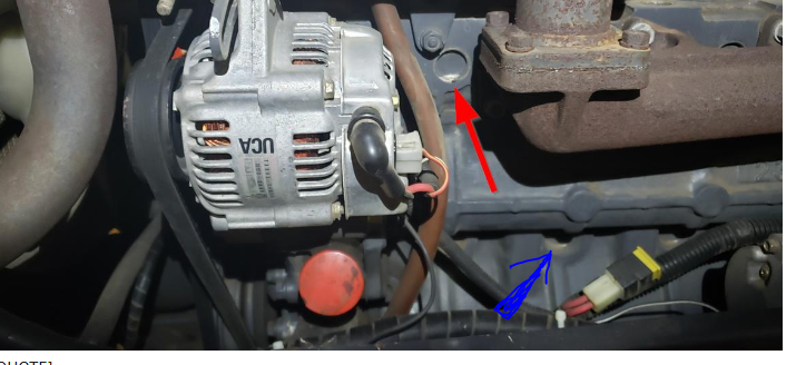

Hi guys. I am waiting to hear back from my dealer as to how much it would be for them to install an engine block heater on my Kubota L4610. I thought in the meantime, I would do some research and figure out how involved it would be to install myself.
I'm not finding much info on it though after doing some searching. Does anyone happen to know of any instructions or youtube video on how to do it? If there is instructions that are similar enough to what I have, that would work also.
Right now, I'm not even sure where on the engine it would be installed.
Thanks!

I installed mine this summer…There are a few videos out there on it…it’s pretty easy….
That's an easy one.
Drain the coolant
Pop the freeze plug out of the block in front of the starter
Do not DRILL!, just tap one side of the plug with a punch, the plug will spin, then pull it out with pliers.
Drive in the sleeve in then install heater and refill coolant.
there is good video on the motor that’s in the l4610…I think

Thanks! Is there more than one freeze plug to choose from? I'll have to look later and see if I can find the one by the starter you are referring to.
Do you need to wrap the sleeve in anything to help it seal? Or, just drive it in and it's fine being metal on metal?
There will only really be one freeze that will stick out as being super accecible.
I never really put anything on my sleeves and I've yet to have one leak.
Use a chunk of soft wood to drive it in, don't drive it in hard (no sledge action).
