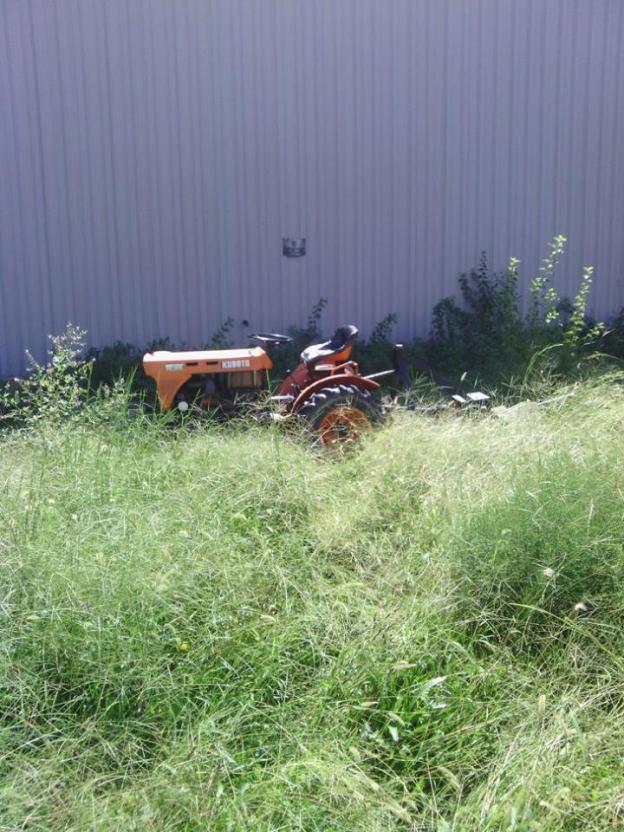

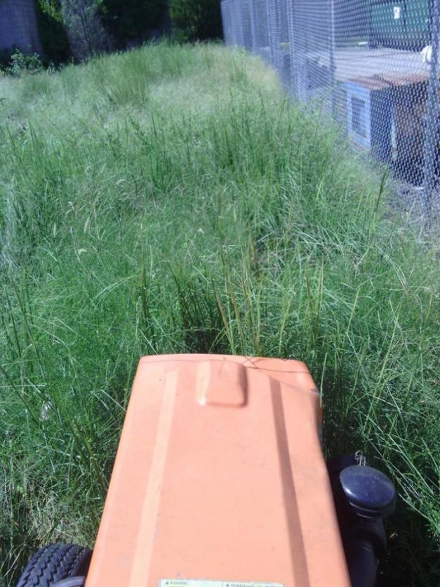

Yall keep saying "heavy stuff" like its impossible to mow through. I cut a back lot that was over the hood of my B6100 with a 4ft hog and at the same travel speed I would at on any other project and no problems what so ever.

Ohhh it was THICK!!! I'm 6ft4 and most of that came up to my crotch and some up to my waist. It was difficult to walk through checking the area for objects. I had to pick my feet up high to walk around.
