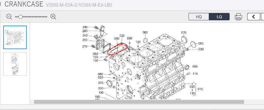

Good morning Wolfman, I contacted the local Kubota dealer and was told there are four thickness options for the head gasket. I'm gonna start by pulling the head and if all looks good I want to be able to re-install the head. I'll need a gasket and want to buy the correct thickness. Any recommendations on thickness? And what's the o-ring? Didn't see one on the diagram? Thanks! Mike
36,875
11,555
You will need to have both the engine serial number (bottom picture in red) and number off the head gasket (yellow marks), you should be able to read them before taking it apart.
AND FYI there is 5 head gasket options for that model. 🤪
And yes there is no O-ring on that model, it's built into the head (Blue circle).
