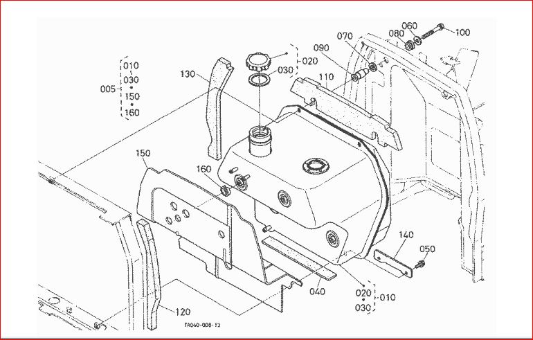

Hello All,
I've been lurking for a bit but never posted. I have had my tractor for about 10 years but have never had to dig into like this. My fuel tank sprung a leak, and I have been trying to remove the tank with little success. I think my last step is to remove the shift linkage for the Forward/Reverse shifter, but I have no clue how to do that. I have the firewall(not sure if that's the correct term) completely disconnected, but the shift linkage is keeping me from moving it out of the way enough to pull the fuel tank out. It looks there is some sort of pin holding the linkage on, but I can't get to it. Any advice is greatly appreciated!!!:)
Thanks, Mike
33,500
8,766
Here is the pic of the bolts that need removed to get the tank out.
The firewall (#150 ) is called a shutter plate. :)

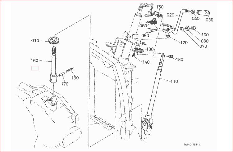

If you need to remove the dash to get to the bolts and you also need to remove the lower section of the shuttle shaft it has 2 roll pins (#170, #190) one inside the other, remove the inner one first.

That's awesome thank you!! Is there a special tool that I need to remove pins 170 & 190? They are at such an angle that I can't really get at them with a punch.

Just picked up a Roll Pin Punch set, hopefully that does the trick. Kubota doesn't make it easy to work on these things. :mad:

Finally got the tank out, Roll Pin punches worked great. It finally donned on me that I had to prop up the dash assembly with a 2x4 to get the best access to the pins. I had to removed the framing that the tanks mounts to in order to get the tank out. Unless I wanted to disconnect all the hydraulic lines for the steering. I think the hydraulics for my FEL were in the way.
