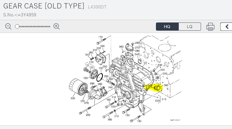

Should this reservoir be filled to the top and with what sort of oil its a black plastic cap with oil written on it just below the alternator thanks in advance

Some Kubota engines have more than one motor oil fill, since they're used in different equipment/configurations.
33,388
8,700
Are you talking about this plug / cap?
If you are, leave it alone it serves no purpose to you.
There is just gears and splashed motor oil under the cap.
