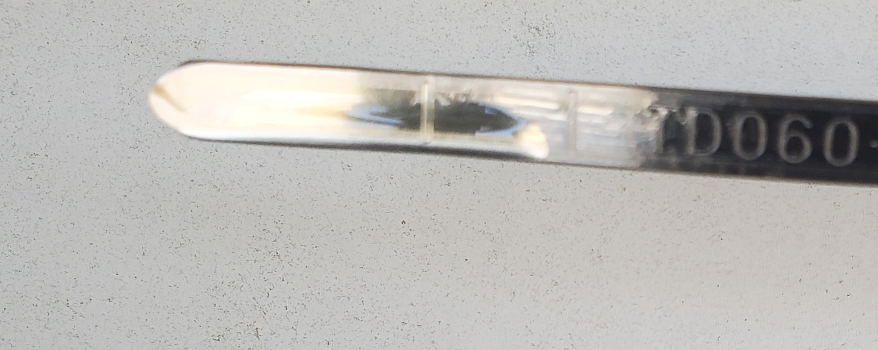

So checked the transmission oil. Thin. Clear. Doesn't smell burnt.

Has it done this new behavior it between multiple fluid, and more importantly filter changes?
I'm thinking maybe a blocked HST filter could be causing issues.
