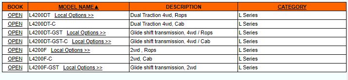

Maybe HST? (which to me stands for Hydrostatic Transmission)
BTW what does GST stand for?
I thought maybe, but they didn't offer a HST for that model either.
A I hope for his sake it's not a F-GST as that's not 4wd like he stated.
GST= Glide shift transmission, think of it as a semi-automatic transmission, you can shift any gear to any gear at anytime and the clutch is not used to shift between gears.

its a shifter on the left side like a car shifter, it has 1234 so it a l4200dt model

Yep a DT.
A GST would be N12345678.
