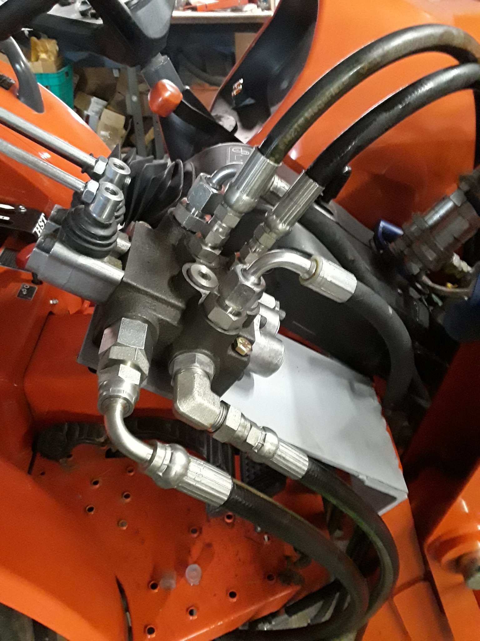

3 function on the loader for an auger.
A third function valve is typically mounted on or near the loader valve. There are "universal" kits for kits for installing a pushbutton operated electric valve. They provide the basic pieces but you have to do a little fabrication to mount them on your particualr machine:
Another option is to use a much less expensive manual valve. I would consider it a better solution for controlling something like an auger. You can also add moire than one spool and use the additional spool(s) for rear remotes. It could be mounted on the loader or the fender like the OEM valves. If its on the fender it would remain with the tractor should you remove the loader.
