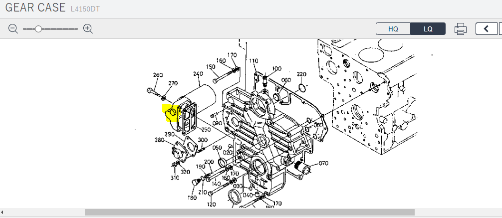

It's more likely that the relief valve.
Super easy to get to and check.

Thanks Wolfman - I was just looking at that part and wondering if it could possibly be related to my issue. Can it be cleaned or should I buy a new one?
