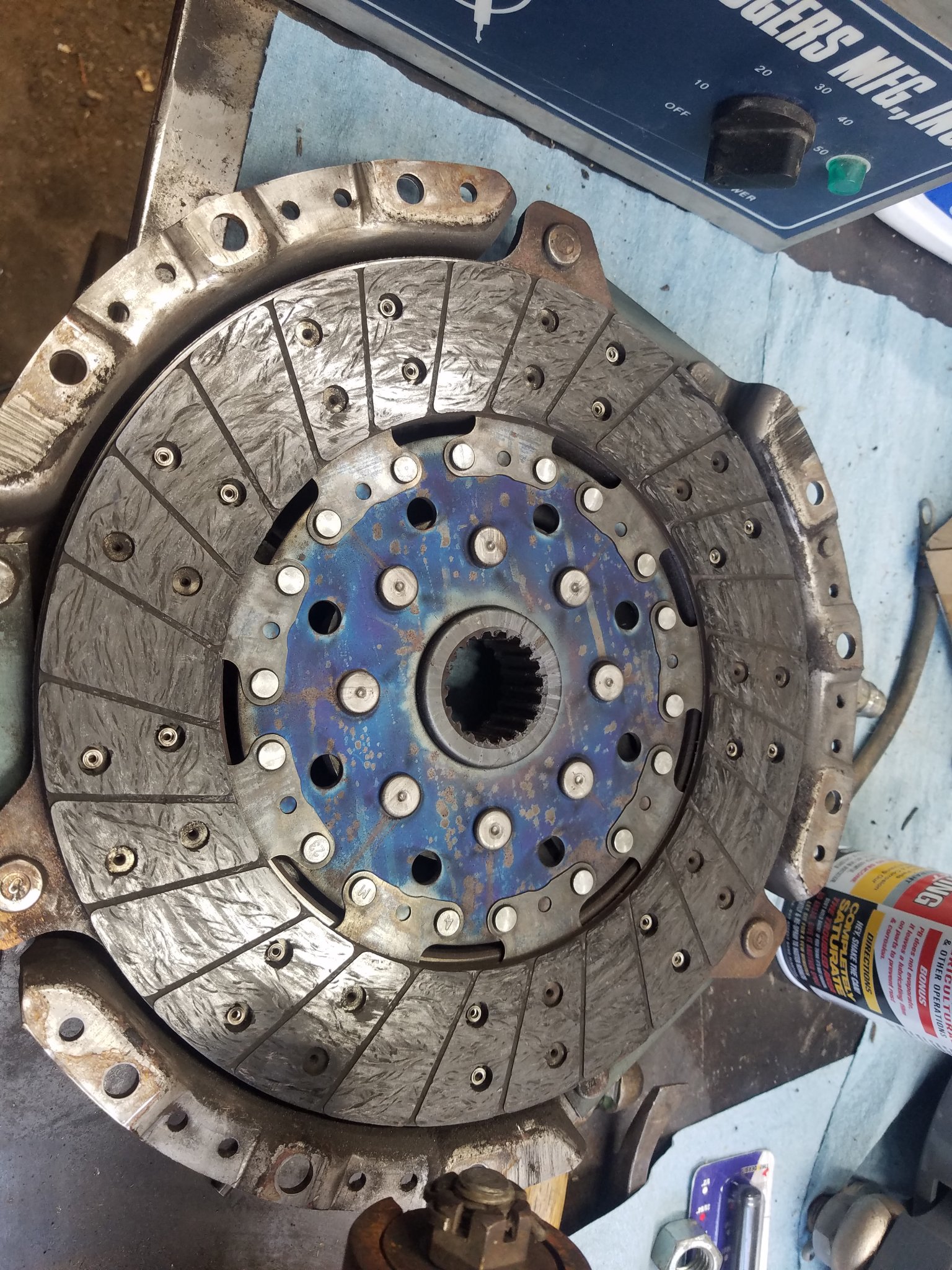

Well, looks like the main clutch... Thanks to @PoTreeBoy for suggesting.
I took the starter off, and the top of it was covered in clutch fibers.
I would have to say that I was fooled - because the clutch housing is sealed - meaning that any smoke or fumes from a hot clutch are trapped.

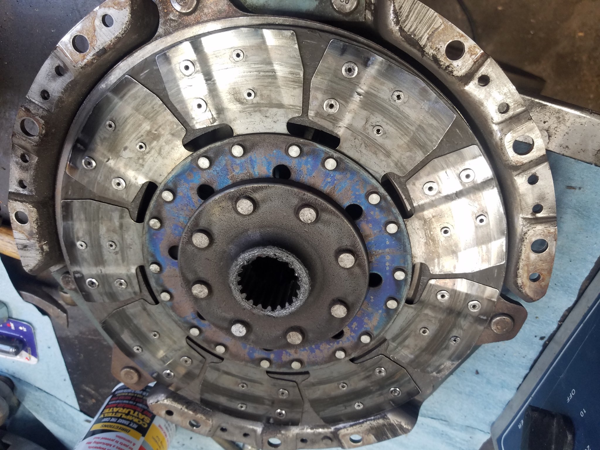

And...[drumroll]...The flywheel side of the clutch looked fine. But there was zero friction material left on the other side. The flywheel looked great. The pressure plate had wear on only about 90degrees of the outer edge. I haven't looked closely yet, but it suggests that something got lodged there. Clutch on Flywheel Side.jpg

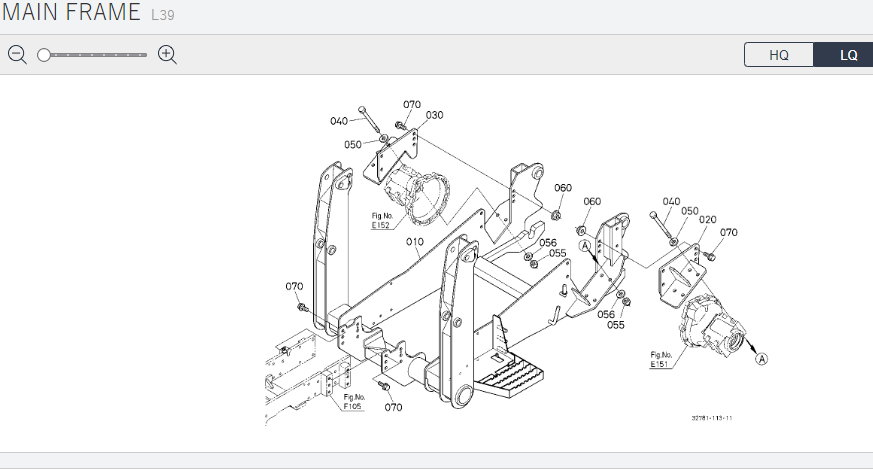

How did you end up splitting the tractor? By looking at my L39 with the loader TL1000 and backhoe BT1000 it would seem the tranny has to come out and not the engine being pulled the way the frame and all is set up. I'm having a similar issue where I can drive it and rev mine up but it's acting like the dry clutch is slipping really bad. I'm going to try and pull starter like you did and just see what I can but I'm a little lost on how to get into the clutch housing itself unlike other tractors I've split they were easy compared
34,075
9,277
They all split the same way at the bell housing.
You'll need to loosen up the frame to get it split.
