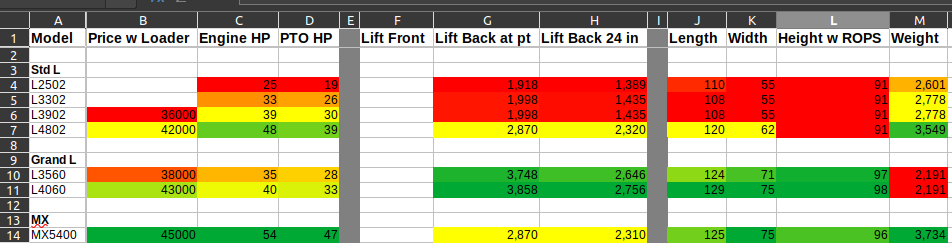

Updated my compare tracker with the Grand Ls and MX5400. The MX has been a consideration but not sure I could make that work financially. The Grand L wins outright on 3pt hitch weight capacity, but the Kubota spec sheet says it's lighter than the 3 smaller Standard L models? Seems odd. Is the advantage of the Grand L 3 point hitch the ability to more easily add remotes for something like a flail mower, compared to the Standard L?
The L4802 would be pushing the budget, especially after adding tax, KTAC, and implements. However it seems like a completely different class of tractor compared to the L3902 and has several advantages that I'm looking for like the larger frame size and weight.
I think you put the Grand L LEs on a diet, less than 2200 lbs. I’ve the glossy here and it says 3649 and 3748 lbs. Also, none of the weights in the table include the weight of the FEL and bucket, which is around 500 to 1000 lbs, or any fluid ballast at 500 to 1000 lbs. The larger tractors being on the higher end of those ranges.
I like the use of color gradation to rank the specs.
