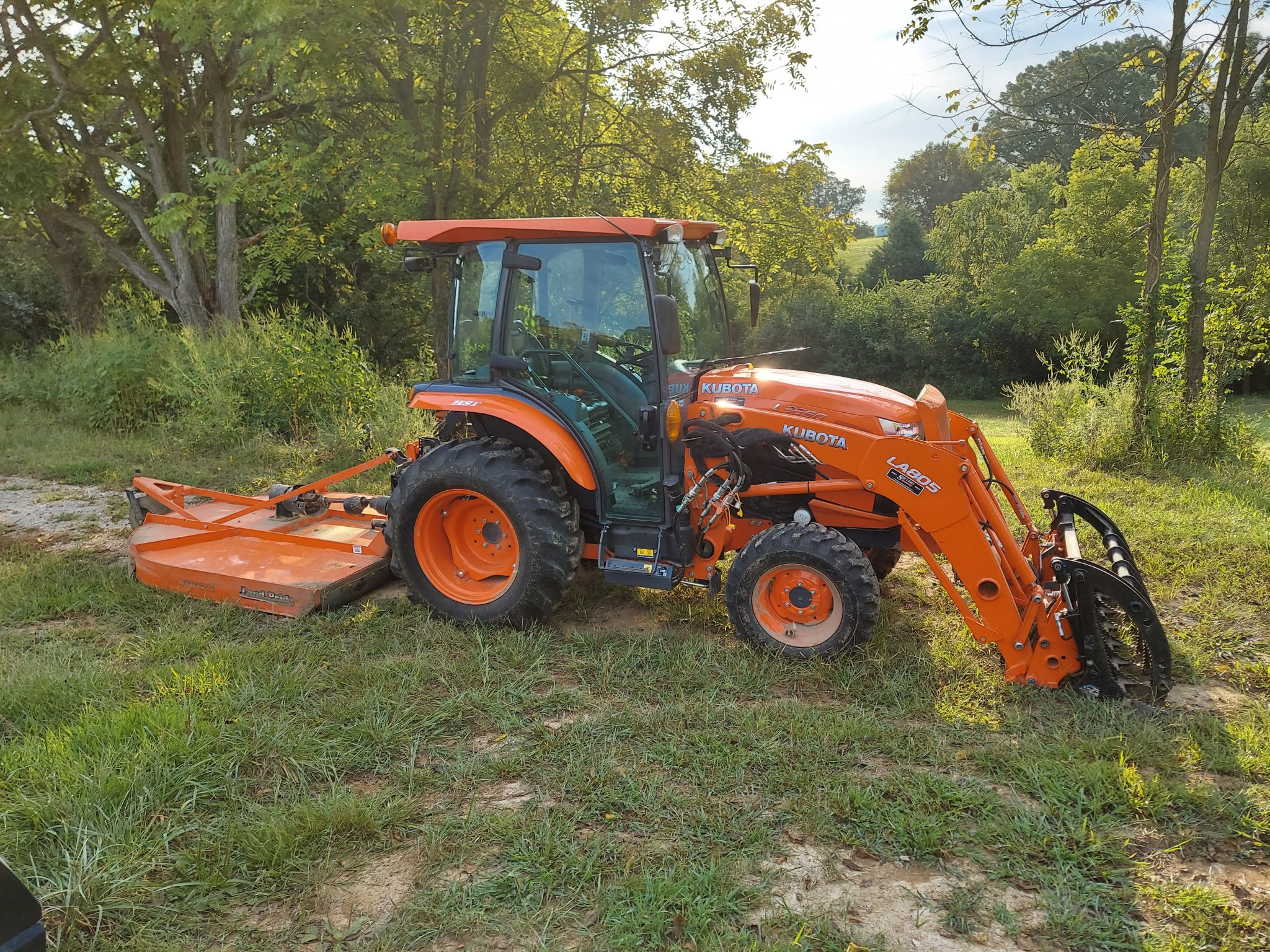

I bought a used L3560 last year and a new RCR1872 brush hog. Used at home on 2' tall stuff with no issues at all. Headed to farm for 3'-4' tall stuff with sumac up to 1" in it. Based on what I am seeing I don't anticipate any issues. Worst case I slow down some on the really tough stuff. 700 pounds heavier than the 3902 and mine has fluid fill tires on top of that.

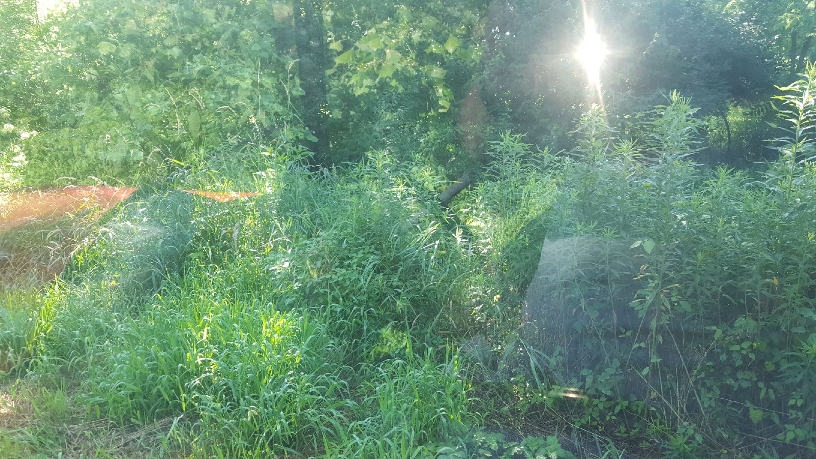

Well, here is what I have done
This is the stuff I have mowed through with the 6ft mower
It isn't a bulldozer. I have taken down small saplings, usually an 1 inch or less with the mower. I can't address the tiller question because I don't have one yet, but that is on my list. I think the two tractors you have on your list are vary comparable. Now if you look at going up to 54HP (5460 or MX5400) then you would notice a PTO difference. Yet between the two you have picked they are so close I don't believe you will see a difference in PTO function.

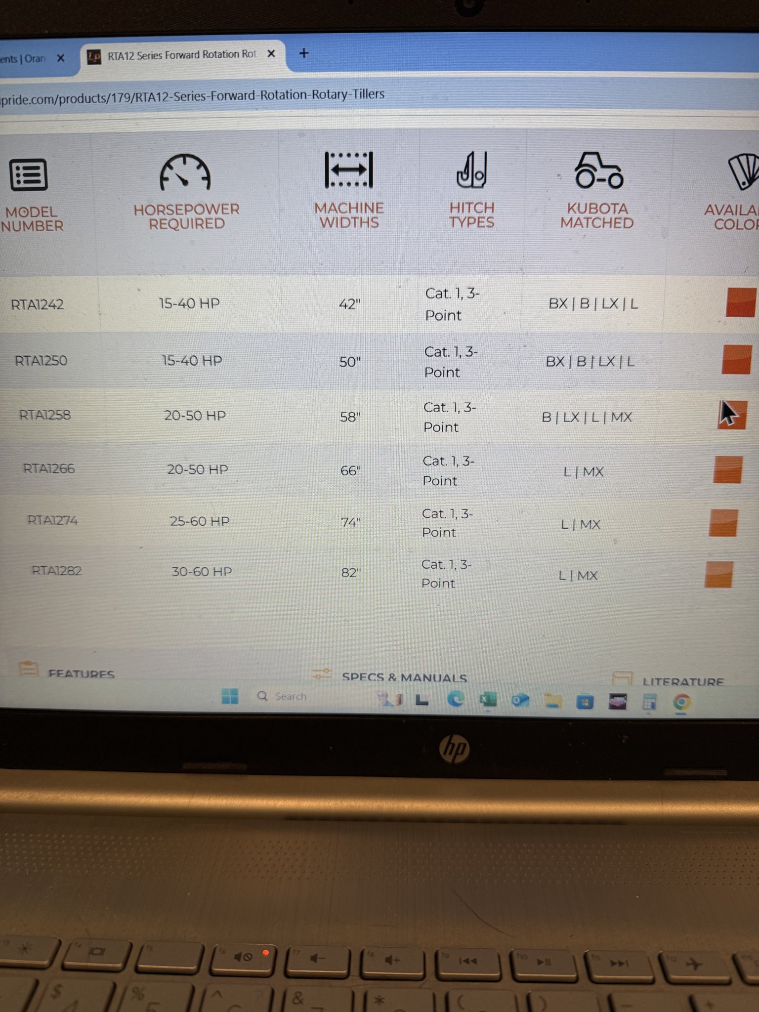

A helpful tool which may help those trying to decide between tractors is the landpride website. Take a look at the type of implements you think you may be using and then look at the tractor match recommendations it gives. Not an exact science because not everybody buys landprides, but it does give a pretty good estimation of what widths and weights work with different tractors. Attached is the chart for RTA tillers as an example and shows the RTA 1266 matches with L's and MX's, the RTA 1242 matches with BX/B/LX/L .
Each type of implement can be checked this way.
