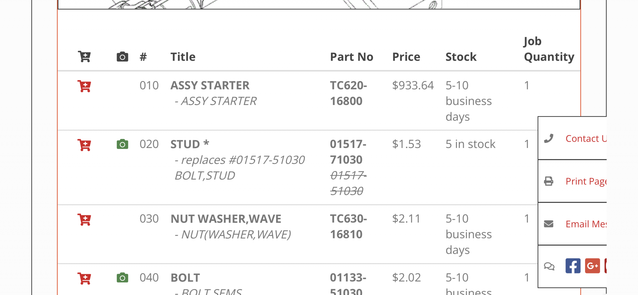

I am looking for a good part number for my L3901 Kubota tractor. My starter does not have any numbers on it. it is a denso starter, but any brand will work. Thanks for any help.

Kubota part number: TC620-16800

Thanks for all the help. All the other starters for the Kubota's tractors cost less than $200.00 dollars what makes this one special.
