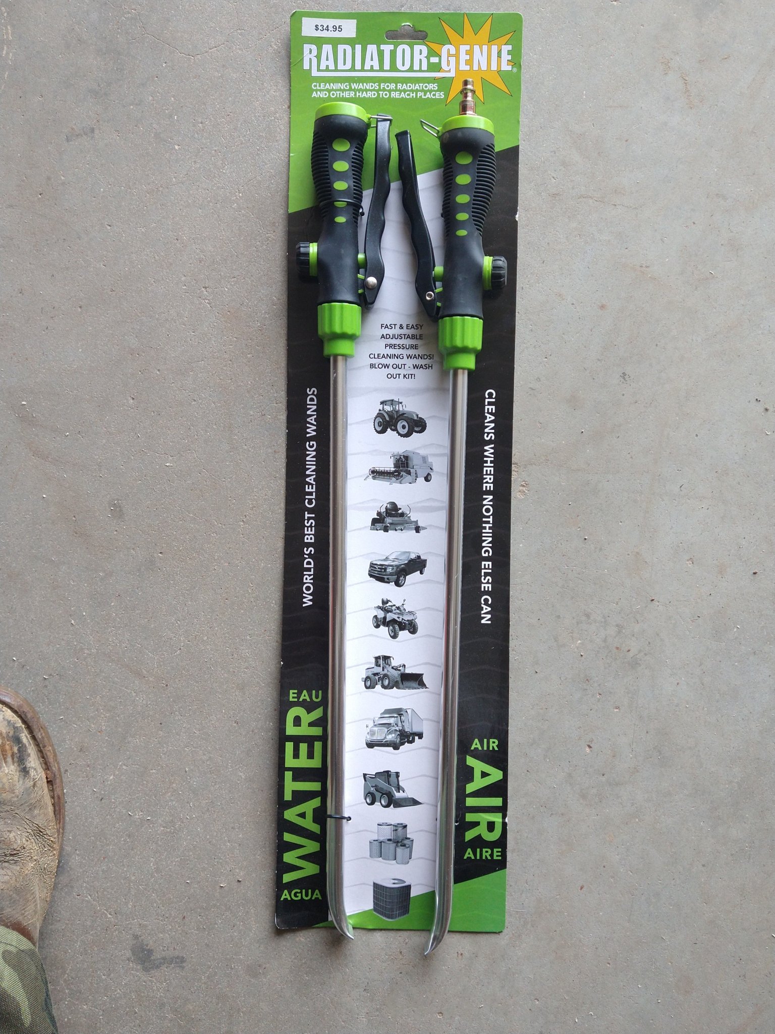

Cutting with the front slightly lower takes less power, but doesn't leave quite as "nice" of a finish cut ... I pull a 5" brush hog with my 25 HP SCUT (19.6 PTO HP) , but I mow 5-6 times a year, first time was slow going!
Maybe slow down the ground speed a tad if lowering the front doesn't help ...
I use the air most often, and if I use the water, I use it after the air ...
