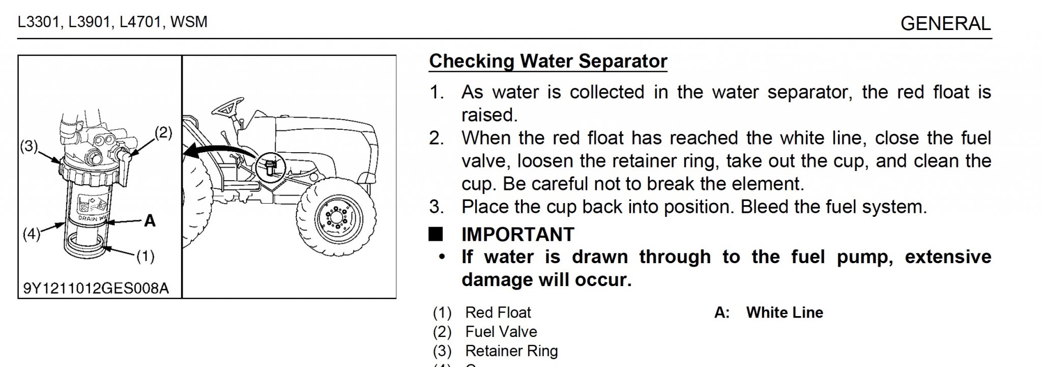

Like fordtech86 says check your fuel water separator bowl (see attached) when it dies. If its empty or partially empty you have a fuel restriction from tank. Do you use a fuel additive or algicide?

Big G, what? On the 33, 39. 4701. common rail the fuel systen the water separator is not the fuel filter. The fuel filter is a spin on can on the upper right side of engine. (see attached)

The fuel water separator is a wire mesh screen that gets cleaned and reinstalled.. It is not a paper filter that gets replaced.
