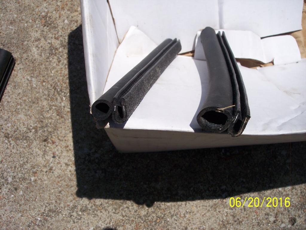

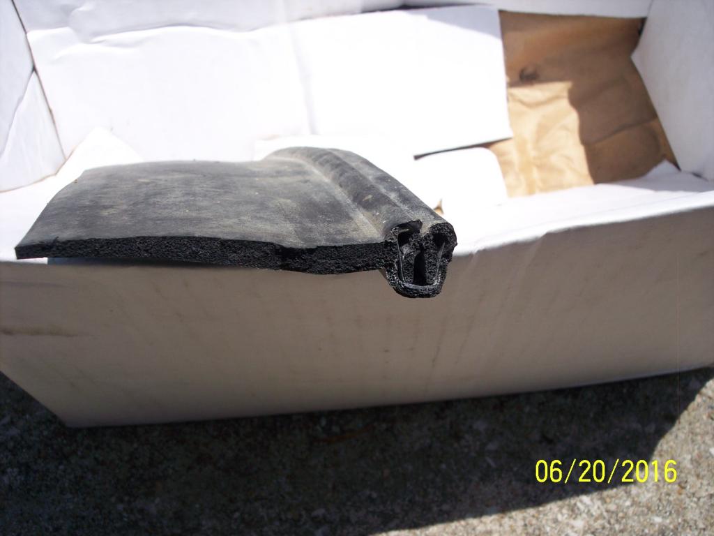

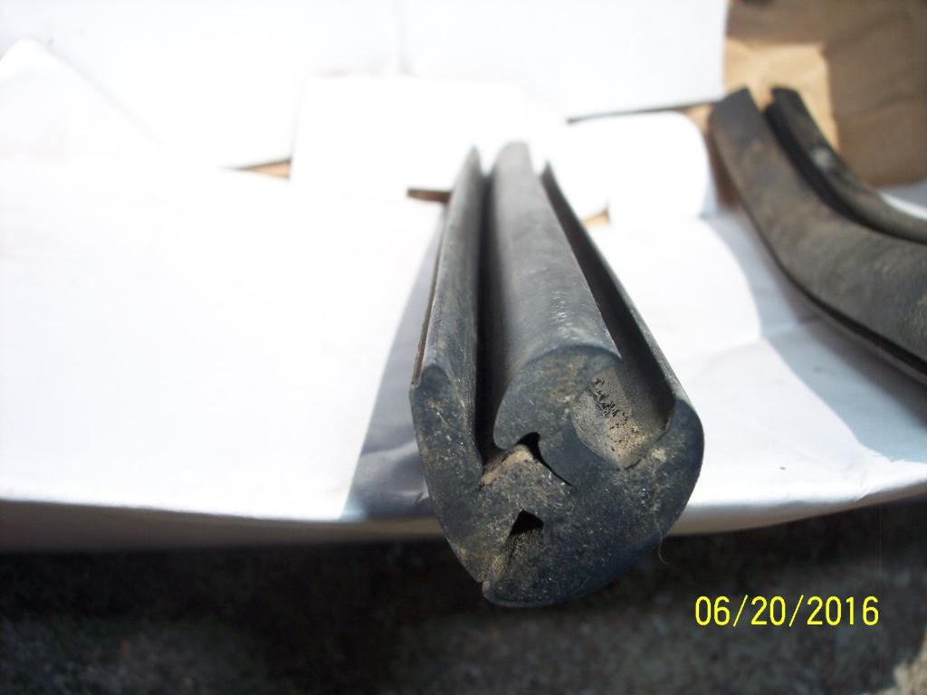

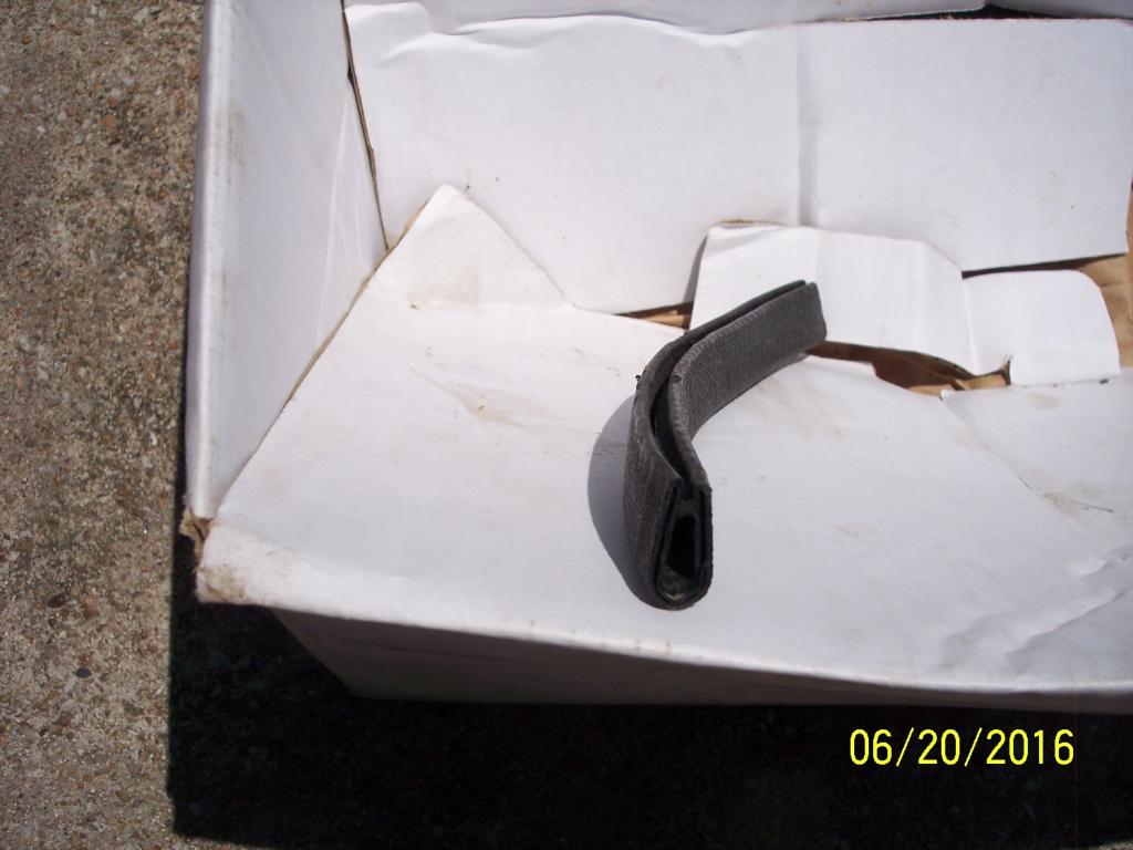

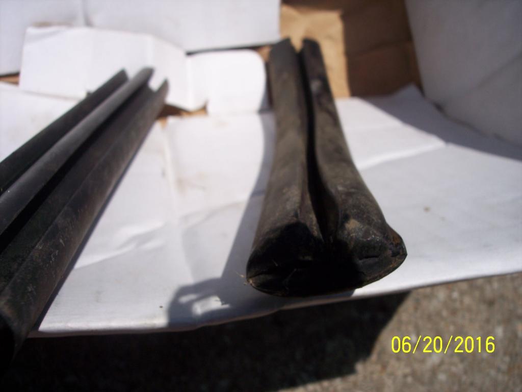

You guys fabing cabs, if you need some weatherstripping I have various shapes and sizes. You pay postage and .40 a ft.
