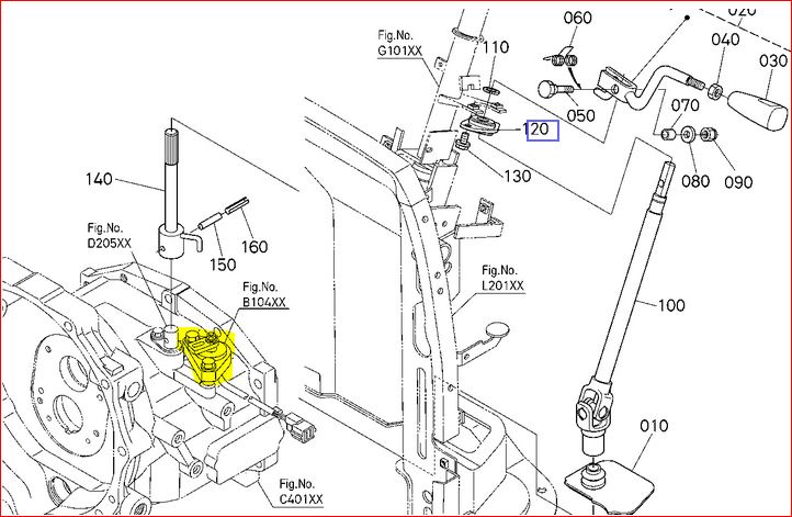

I have a L3830 GST. To start the tractor the shuttle shift lever must be in the neutral position. As of late, I am encountering difficulty actually achieving the neutral setting and it requires significant jiggling to find neutral and thus get the tractor to start. Does anyone have similar issues and what might be the problem. Thank you.

Safety switch may need some adjustment. Most of them have no room for error. I would track down the switch location and check it.

You always find the best pics Wolfman.
That looks a lot like the switch that's on the high/low shifter on my L3000. It was giving me trouble and the tab, arm, finger (don't really know what to call it) was loose and the shifter had to be moved to the right spot before it would crank. Small adjustment and tighten the screw back down, it worked fine.

Wolfman, that's exactly what I was talking about. I agree with your first statement though, it doesn't really have adjustment. Finding mine loose probably isn't the norm.

My thanks to all of you who responded. I dismantled the protective covers and cleaned all connections and lubed those which appeared to be in need. I also disconnected the main switch and cleaned both male and female leads. It seemed to solve the problem, the tractor works fine now. Again, my thanks.
