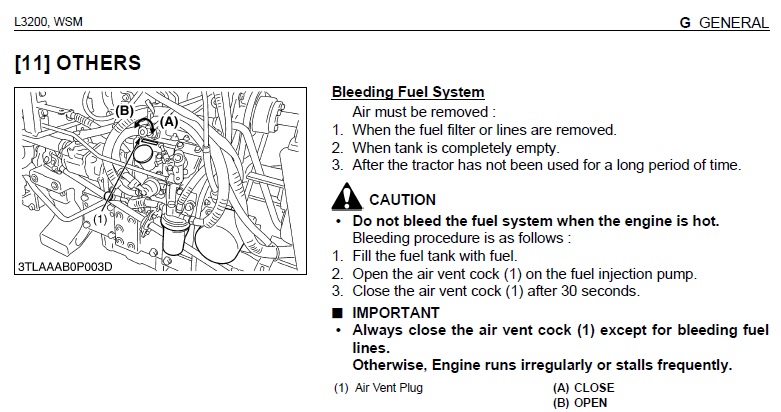

I may be off base on this. I notice your fuel system diagram looks the same as my L35, but the bleed instructions are written differently. The L35 instructions are to open the bleeder valve and leave it open for 30 seconds after the engine starts. Yours just says 30 seconds. Did you by chance just open and close it without starting the engine? Since we have mechanical lift pumps, if the engine isn't cranking over no fuel/air gets purged. Hope this helps.

I’m at a loss. I really thought loosening those fittings was going to be the ultimate solution.
The L3800 does not need to have any lines loosened to bleed air.
The L3800 shares the same manual as the L3200. The manual page posted for the L3200 is all that is necessary. Turn the bleeder knob as per instruction. Set the throttle a bit above idle, and start the engine. Once started, move the throttle about half-up to a decent rpm, and the air will be purged. 30 seconds of this should clear the system. While the engine is still running, close the knob as per instruction.
There are so many videos and what-not showing to crack the lines, but on the L3800 it is not necessary and is just a time-waster.
Also follow directions to fill the tank so that gravity is working for you to move fuel initially.
Good luck
