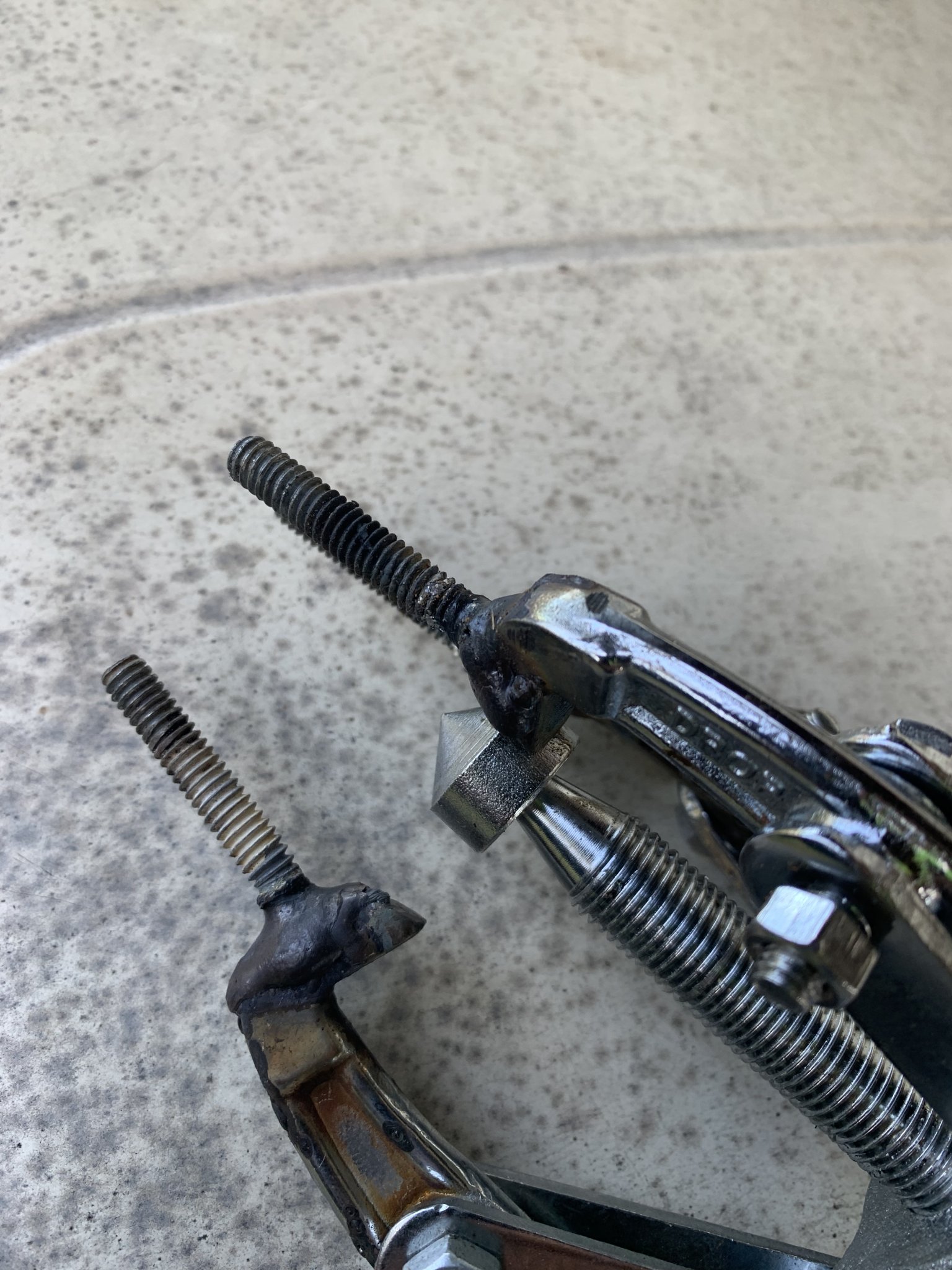

I don’t know about the reinstall yet cable is on Oder but the wheel removal was tough puller was tearing at the wheel so I redone my harbor freight puller there are three holes inside center of wheel I welded three bolts to puller jaws and still had to use impact
