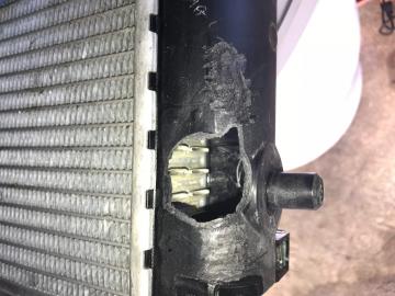

L3800 Radiator elbow broke off!
aasu03
Kubota L3800HST
Nov 2, 2016
14
McDonough, GA
So yesterday I was bush hogging and a mean-stick poked into my engine compartment right where the lower radiator hose connects to the lower radiator inlet and broke the plastic inlet pipe. Aside from why in the world it was made out of plastic.... Does anybody have the part number and a cheap source for a new radiator? Are there any aftermarket companies that may have a cheaper option than OEM? My local Kubota Dealership quoted me "$435 plus tax & shipping for the part and 'bout $300-$350 in labor".... That's at least $800 in my calculation which is a bit tough to swallow. I appreciate the help.

I would not give up on yours too soon unless you are seeing damage beyond what you have described.
Have you talked to a rad shop? Some can work with plastics. Not unlike car bumpers where some amazing glues exist.
It is only the rad tanks which are plastic, the heat transfer parts are metal.
Here is a link worth reading.
https://www.polyvance.com/radiator.php
Please post some pictures of the damage.

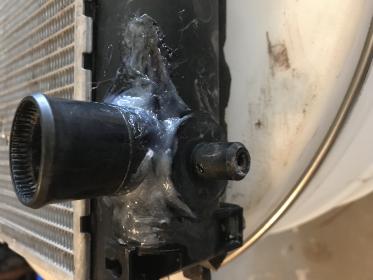

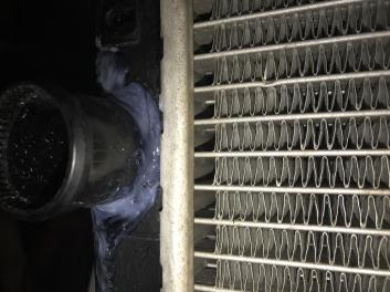

So here’s where I’m at... I’ve removed the radiator, cleaned the area, and then I used my soldering iron to melt/close the cracks running away from the hole. I added an epoxy used for nylon/plastic. I hope the photos work. Also, I figured I’d go ahead and replace all the hoses (coolant, fuel, etc.), thermostat, and the radiator’s rubber bushings while I’ve got the thing apart. I plan to also apply some epoxy internally to fill any gaps there too. Anymore suggestions?!!?
10,977
2,831
I think it looks great - only thing I see that may make a difference, or not, is to place a thicker section WHERE is snapped - thus building that area up and then applying more epoxy as it goes back to undamaged areas. You question about vibrations may cause a problem down the road. Thicker may hold up over time, then again - it might be perfect as it is now!
If it ever leaks or breaks again - gonna be much harder to fix the second time around!!!;)
I hope it works for the life of the tractor!!:)
Now the true test. Before putting it back on you need to do a pressure test.
Go to somewhere like TSC along with your rad hoses. Buy some cheap plastic fittings. One to plug one of the rad hoses and a second to reduce the size to the point that a schader valve will screw into. A schrader valve is like the one on a bicycle tube to add the air to keep in inflated. TSC will have schrader valves intended to be used on well pump tanks to add air to either the old style tank with a floating diaphragm or the new ones with an internal bladder.
You also should get a bicycle pump and a cheap pressure gauge to use with the schraeder valve.
DO NOT USE AN AIR COMPRESSOR!!!! NOT EVEN THE ONES YOU PLUG INTO YOUR CAR.
Fill the rad almost completely full with water.
Put the rad cap back on. Slowly add air through the schraeder valve checking often with the pressure gauge. Since the rad is almost completely full of water which is in-compressible, the pressure will go up much faster than when filling a flat bicycle tire.
If you go too high the rad cap will start releasing pressure. You want to find the pressure just below when the rad cap releases and let the rad sit for an hour. At the end of the hour check the pressure and look for leaks.
Pressure still good and no visible leaks you are good to re-install.
Don't continue to check the pressure during the test and the act of testing itself will drop the pressure.
DO NOT USE AN AIR COMPRESSOR!!!! If you do, even with great care and a regulator it is very very easy to rupture the rad.
Dave

By the time I get all that set-up I could likely have re-installed the radiator. Would it be too risky to just run the tractor for a bit hoping it holds and shutdown the moment I see a leak?
Dave_eng
M7040, Nuffield 465
Oct 6, 2012
5,257
1,043
Williamstown Ontario Canada
The suggested work is going to take minutes not hours. Your way, the engine does not get hot enough to build up pressure and then one hot summer day you are working your tractor hard and the repair lets go.
If you don't want the work to build the pressure tester yourself, buy one on amazon for $80 or take it to someone who already has the tester.
https://www.amazon.com/8milelake-Un...s&keywords=radiator+pressure+tester+kit&psc=1
Dave
100 td
B21TLB (B21, TL421 & BT751) Toyota SDK4 T116 Bobcat
Aug 29, 2015
1,776
9
38
ɹǝpunuʍop
I wish you luck, but for me personally, I couldn't take the chance on seizing an engine. Would do it to get out of trouble if there was no other way, but I'd replace it first opportunity. I really hope it works for 20 years for you though, glues are getting better all the time.
