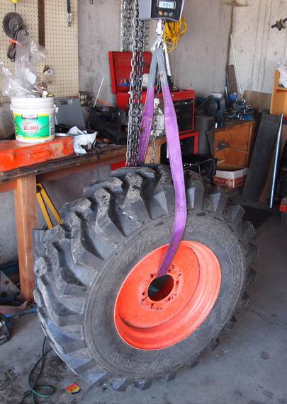

The loaded tire weighs in at 494lbs - 500 is a good guess, or rule of thumb. Note that the rim has no opening for a strap for your engine hoist. I just changed from R4s over to R1s, so I have moved a lot of tire around just lately. The R4s were a lot easier to handle - they have a pretty flat tread and don't try to fall over on you too much. R1s were a bear.
I did the change on concrete, and used an automotive hydraulic jack under the ROPS bracket. That gave me the fine control I needed for lining things up.
I'm 68 and not near so strong as I once was, but I had no real problem either removing or installing the wheels. Just take your time, be careful, and ALWAYS have an exit strategy.

Thanks gpreuss. You are absolutely correct . . . no opening for a strap . . hmmm. I will be doing the change on concrete also. I am 61 and still pretty strong . . just don't bounce as good as I used to. Having been a guitar player in a blues band, I have learned to ALWAYS have an exit strategy . . . ::D
