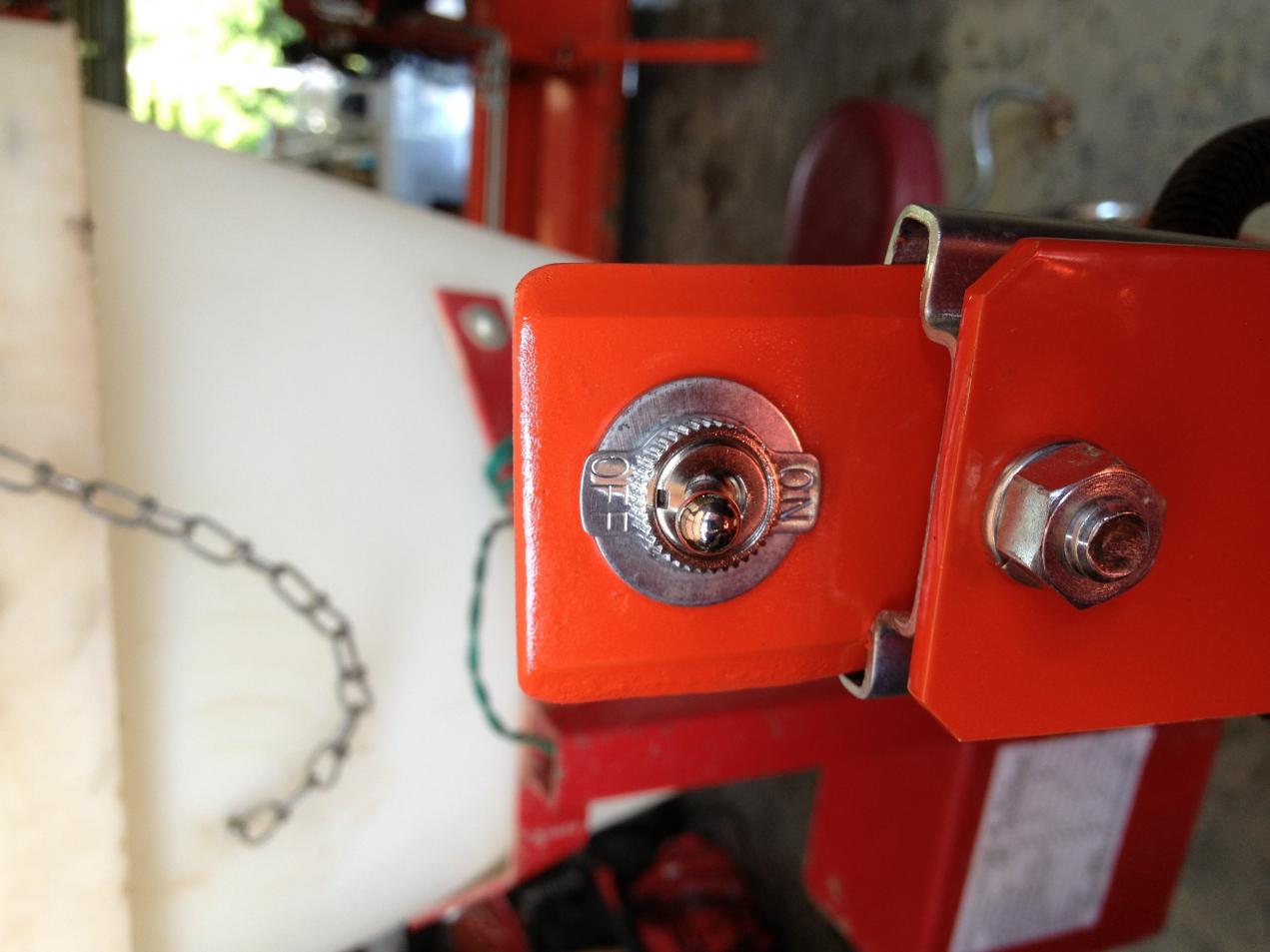

Ok so here is what I ended up coming up with.
I bought a new meter that can measure amps, my old one wasn't capable, it was showing only 1.50 amps on average while the motor was hooked up directly to a lawn mower battery. So I decided to proceed with my original plan.
I rewired it using 14g wire, installed an on/off switch, but did not install the inline fuse, even under load it maxes out at 1.60 amps, so I decide that the 10 amp fuse on the tractor, labeled "work light" would be enough.
Everything thing seems to be working fine. I spread a bushel of old sunflower seeds, with no issue. I even made a nice little switch holder, out of a piece of scrap metal I had laying around.
