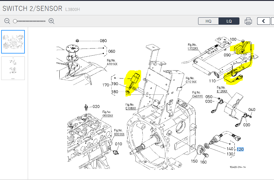

Seat switch or the HST switch.

These are the locations of the 2 switches:
The WSM will have testing procedure for both.
