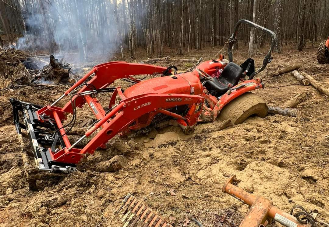

Don't be this guy (from Facebook).
Or this guy...we lovingly refer to him as the 'Happy Dumbass'...... ;)

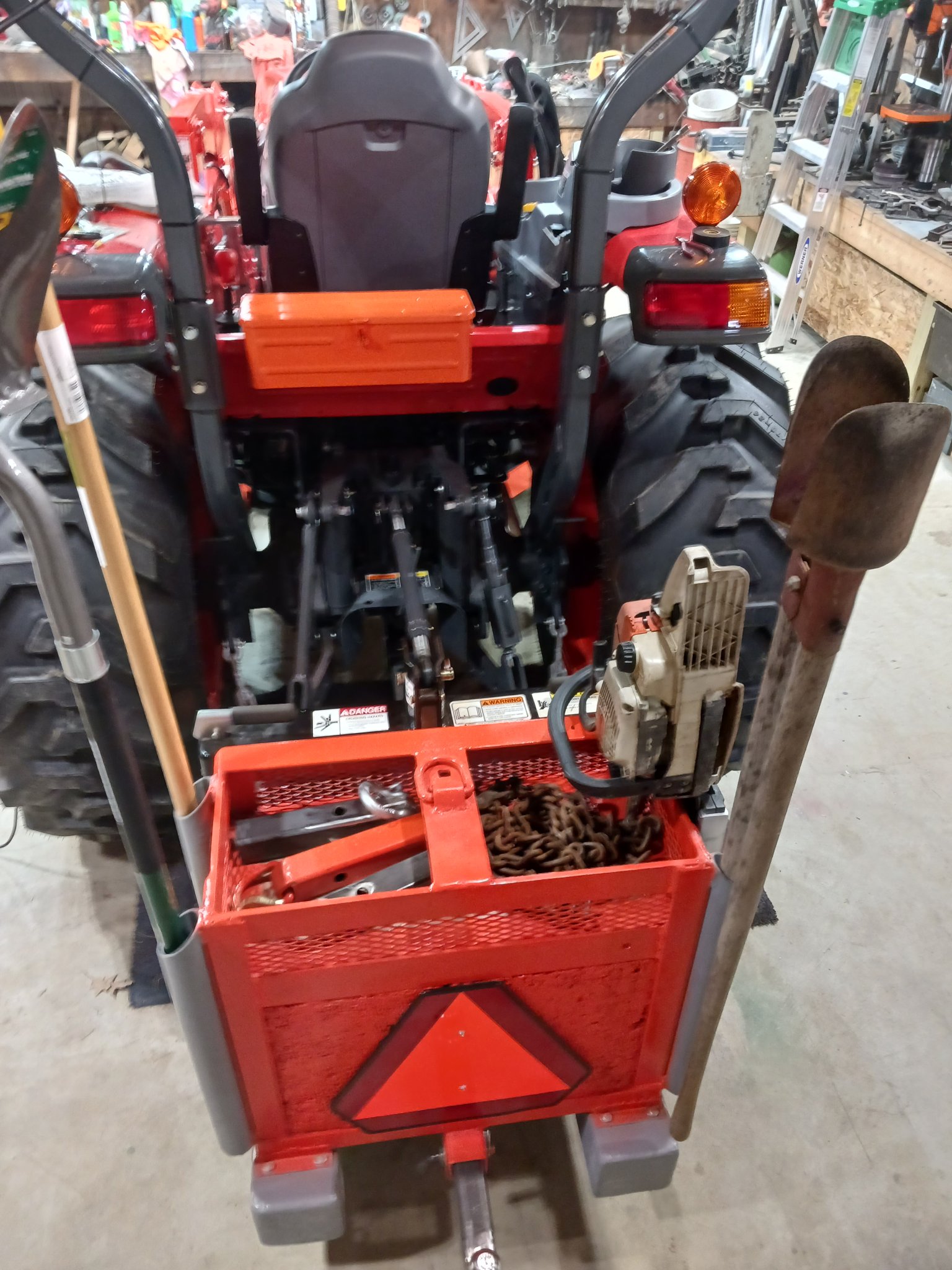

I did something similar to GrizBota's approach, only my goal was to put more (70%) of the weight on the rear wheels. I carry IBC totes full of green firewood across sometimes bumpy ground and don't want to destroy my front axle.
This gave me numbers closer to what NorthIdahoWolfman came up with. I haven't actually made the counter weight yet, I was initially getting by with hanging my IH-80 snowblower off the back when I need to lift the totes with the front but also by buying a set of 3-pt forks, so I can put that 1700 pounds directly on the rear end of the tractor (and by putting a full tote on the back when I need to lift one w/ the front, to stack it on top of another one).
