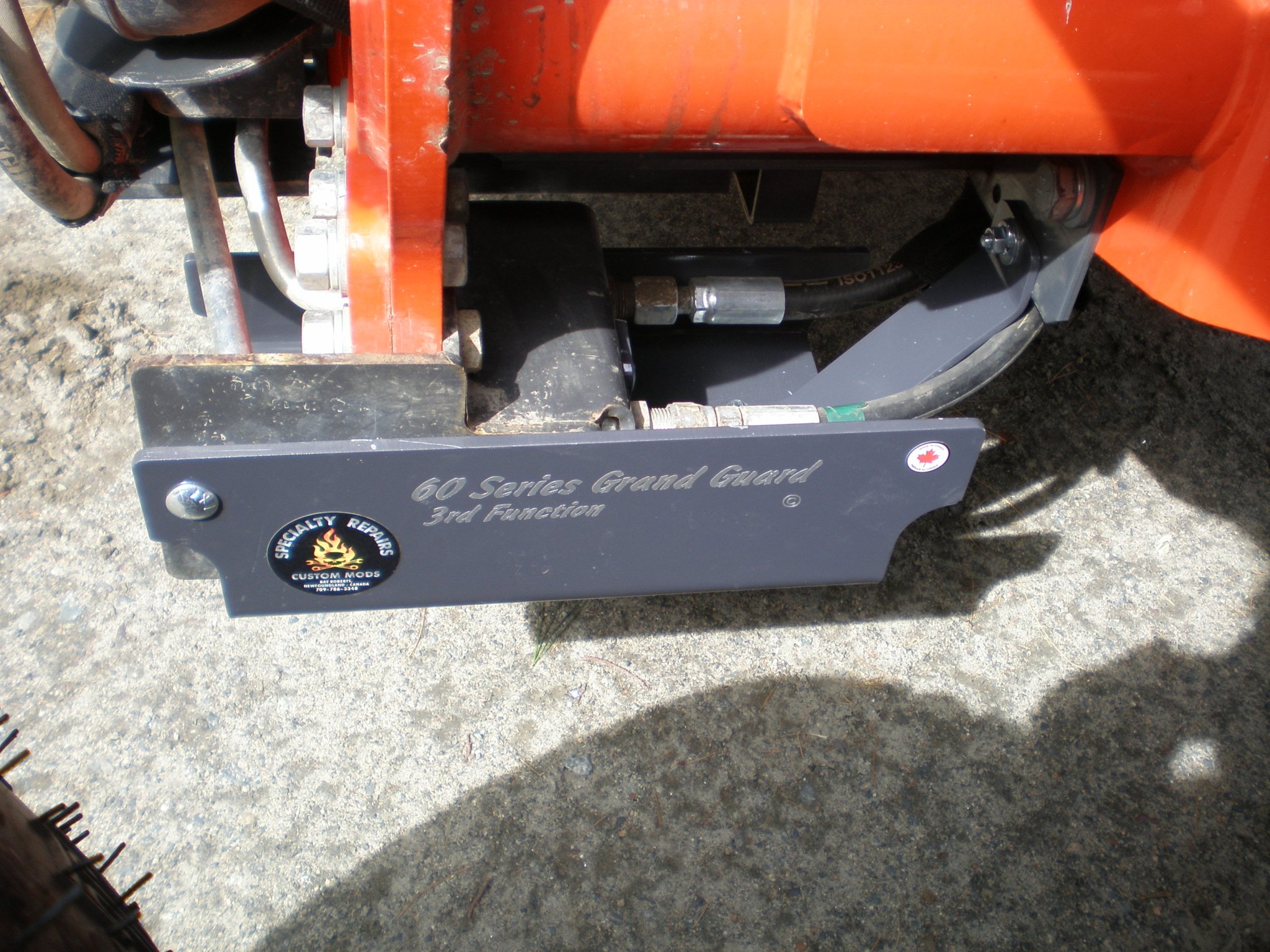

Glad you found it! I found that Kubota tends to leave things open to damage under the tractor. I bought a 3rd function cover from Paul Short in Canada, now I feel more comfortable.
