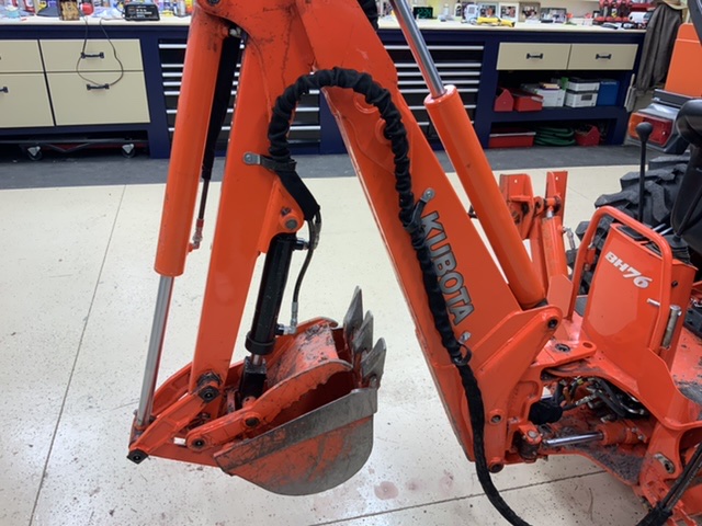

As mentioned...this...
That bad boy has dug out huge stumps and hundreds of very large boulders...
