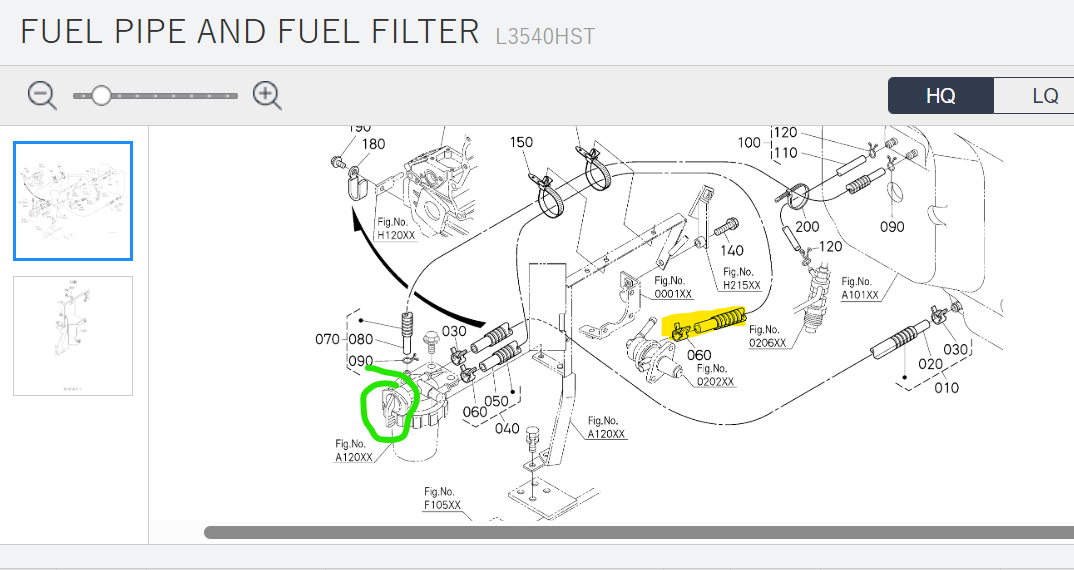

Have you made sure the valve (green) is open?
Take the fuel line off the lift pump (yellow), you should have good fuel flow to it.
Let us know what you find.
Yep, the petcock is straight up and down. I did remove both the fuel line and what I am guessing is the breather line. Fuel was pouring from the fuel line and I was able to blow through the breather line (I could hear gurgling (not sure if that is a word) in the fuel tank.

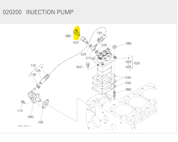

On now pull the small line (return line) off the jet start valve.
With it off crank the engine are you getting pluses of fuel out of the jet start valve?
