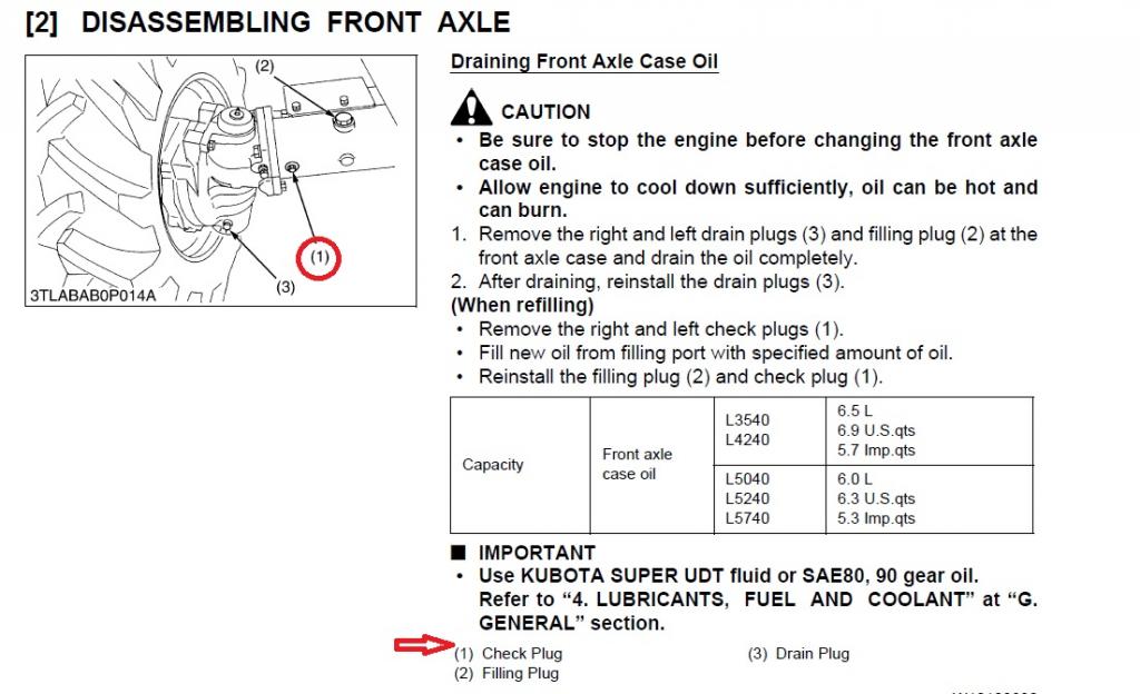

Before doing anything to correct the leak, first check the oil level in the front axle by removing the two level plugs identified as #1 in the illustration.
The tractor should be on level ground when doing this.
If oil does not flow out the #1 level plugs add some until it does so you can safely continue to use the tractor as you try and find the source of the leak.
Next, check the front axle vent line to be certain is is not been blocked by certain flies or wasps which use mud to make nests in small holes or tubes.
Finally, use a stiff brush, varsol and then brake clean to get all the oily stuff off the leaking front axle so you can see where exactly the oil leak is.
If the vent has been blocked or the axle over filled you could end up with a leak which will go away once these conditions are rectified. Such leaks at low hours are not common.
If replacing seals/O rings I see no need to do both sides. I have no idea of costs.
