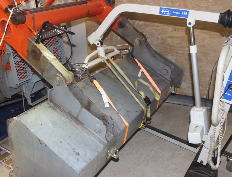

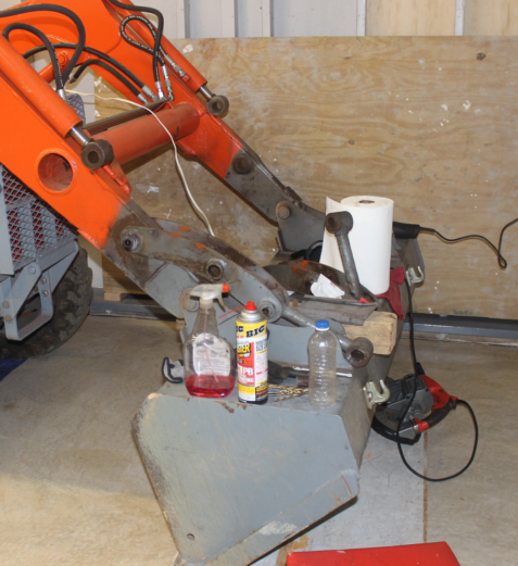

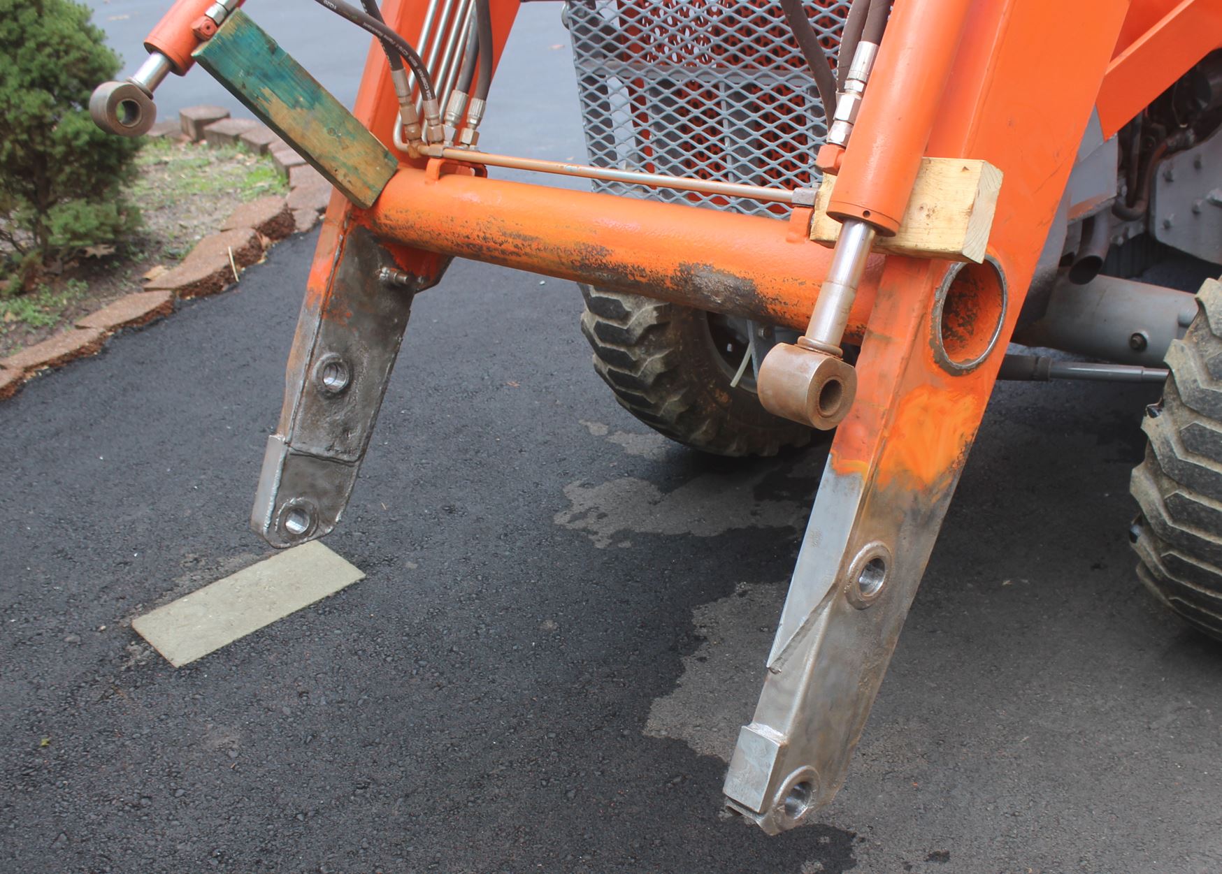

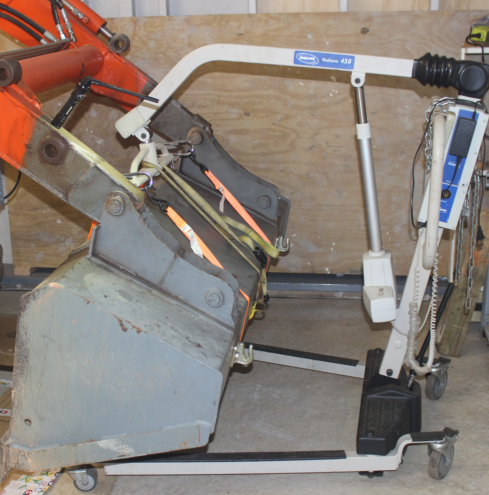

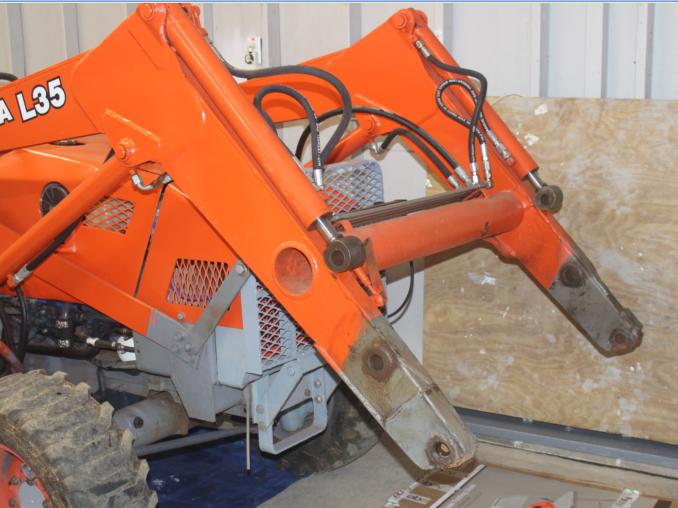

The last abused section of my TLB restoration is the front loader.
Worn pins, worn bushings and totally rusted pins are my nemesis.
There's no getting this bucket off any other way than cutting pins - and that I did.
And no way to do it easily. Several hours of sawing, blade changing, and strong language made it successful.
So let that be a lesson to ya! Grease is good for pins and other tractor things and prevents rust!
if I can't get the old pin remnants out and damage from rust is too severe, I will be making some parts too.
Here's some pics of the current situation.
FREE AT LAST!

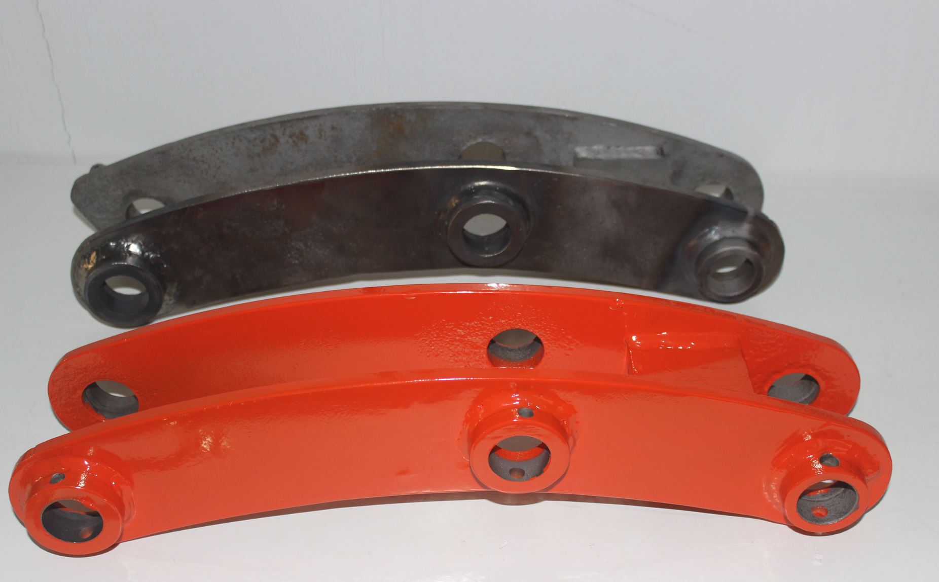

I thought y'all might like to see some progress pics of the front bucket work.
I've got the new bosses welded on the bucket LH and RH links and finished the powdercoating.
Yesterday I blasted the ends of the loader in anticipation of removing the old worn bushings, prepping and painting.
I managed to locate all the bushings and pins for the OEM replacements.

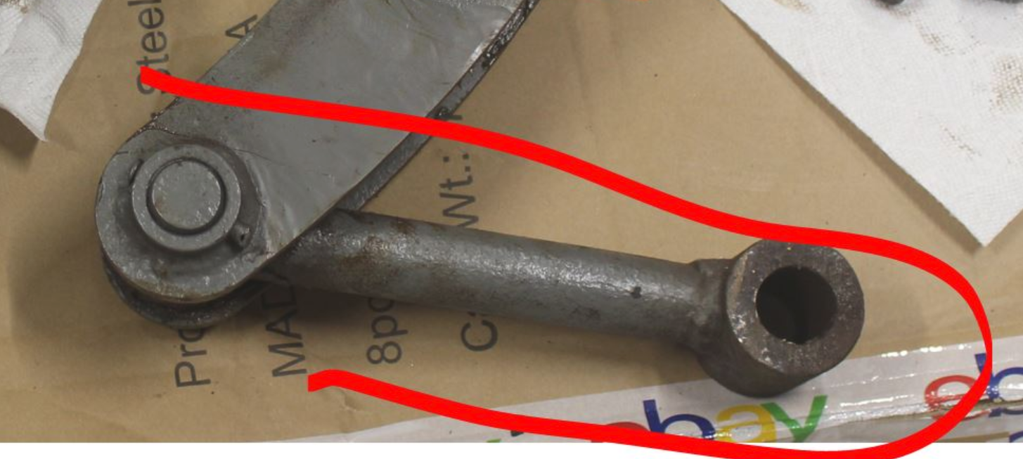

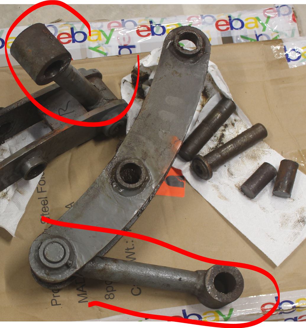

My plan is to either build new dogbone links (last pic) and add bushings (OEM does not have bushings), or machine the OEM to add bushings.
Unfortunately the bushings I need are for the FL and are NLA. It seems that the OEM part number is only for the TL720 Loader.
Much to my dismay, I am unable to find any more - even with recommendations from Messicks. Hopefully my friend at the Kubota dealer can find some 30mm ID that I can use.
I am certain there is a 30mm bushing out there of the correct dimensions I can utilize.
In tractor years, I don't think this is that old of a tractor (approx 1999) given all the old iron out there still running but planned obsolescence certainly seems to be designed into things we purchase these days!
What are your thoughts?

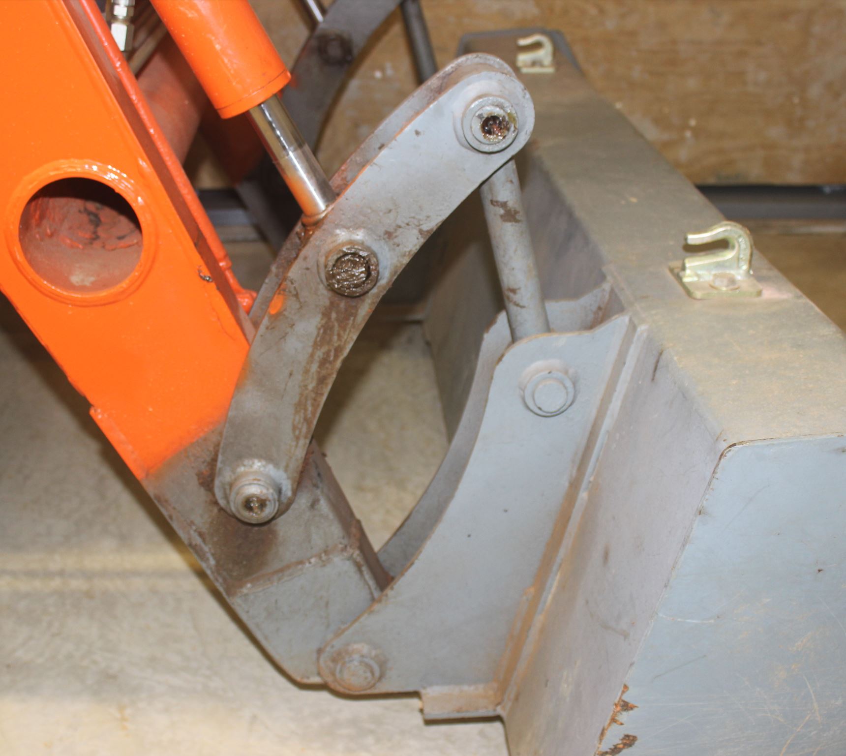

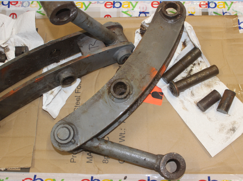

Yesterday I visited my dealer-friend. We tried a lot of things but came up empty as far as in-stock bushings that would match the pins I have for these dog-bone links (below). So I'll visit a machine shop near me and see about getting some bushings made eventually.
I even wrote Kubota HQ asking about 30mm ID bushings and the answer I received was the "check with your dealer" - so I think I'll call this time. Obviously the person didn't understand my question! I asked about engineering drawing and a possible X-ref to other Kubota machinery with 30mm pins/bushings.
The 2 dog bone links in the picture below are wallowed out and are not made to have bushings. That's a bummer. If I can get bushings (made or otherwise) I can get these links machined to accept bushes and move along!
According to my friend, he's seeing a lot of the new stuff built without bushings. Interesting! Is Kubota trying to save money I wonder?
I can also build new dog-bone links, but the ID won't exactly match the 30mm pin size - however they will be pretty darn close and a lot better than these wallowed out OEM links.
Anyway - here is a shot of the original configuration and where everything goes.

BTW, if you all ever need to remove frozen pins (God forbid!) and you can't get a cutting disc or band saw blade in between the bosses, I used a reciprocating saw and carbide blades. You almost need one blade per pin. Then you cut and shake the daylights out of your arms!

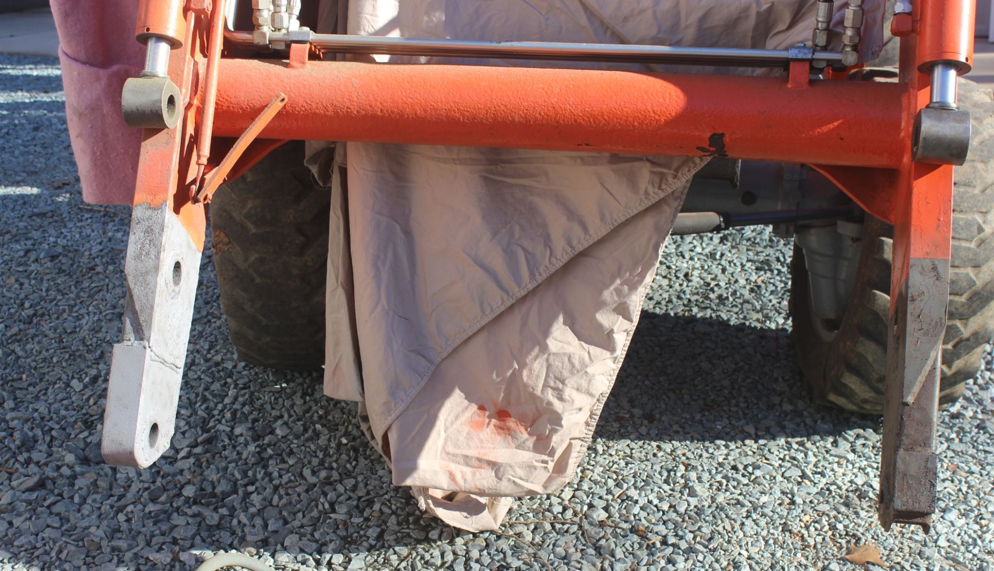

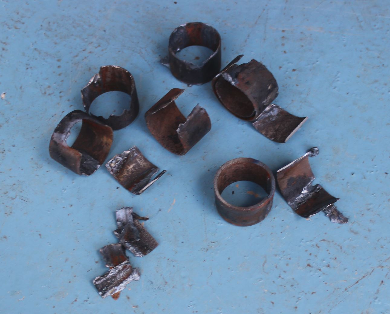

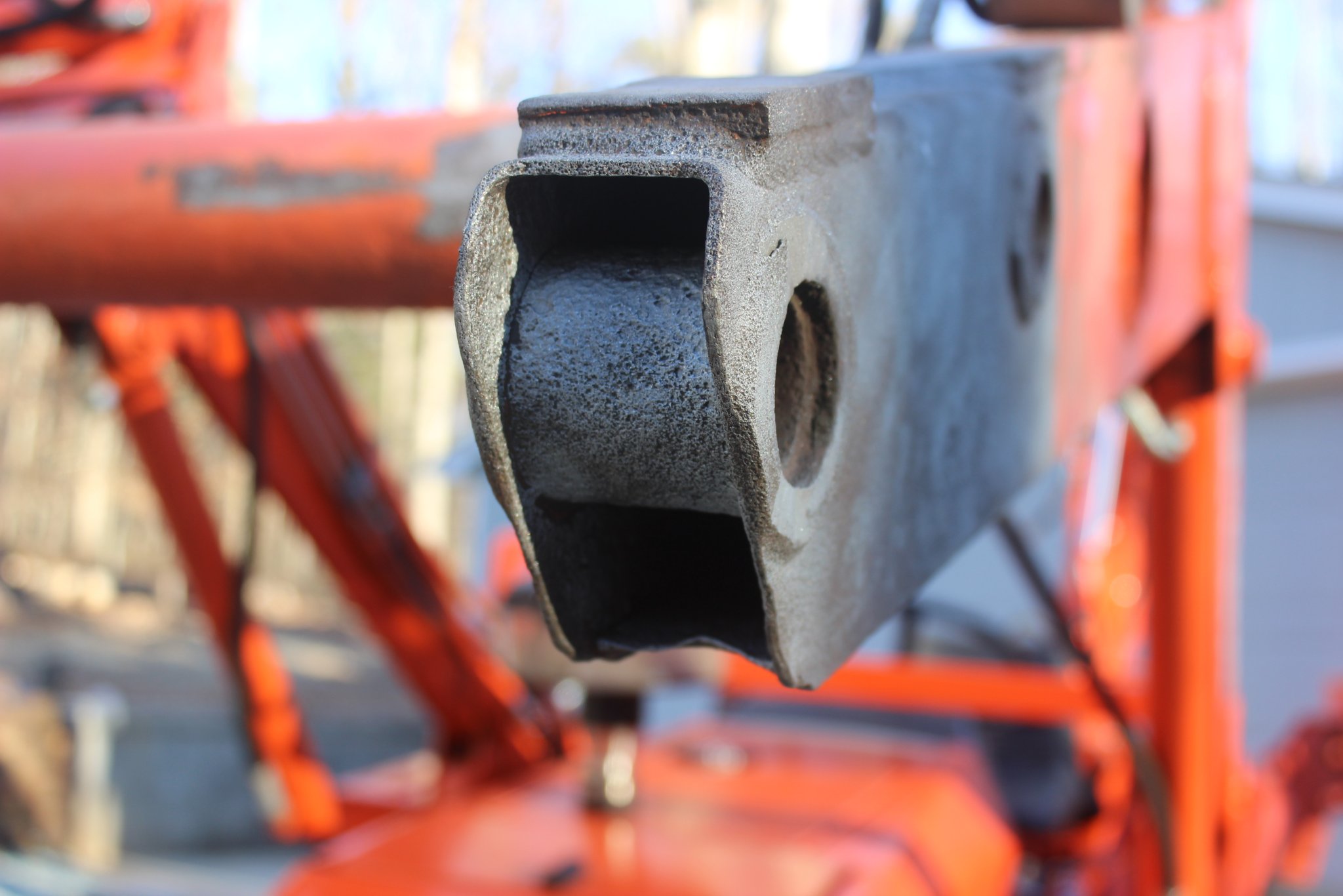

Latest Update (Jan 8)
Yesterday I got out the plasma torch and removed the bushings from the loader frame, cleaned up the frame and began preparing for paint.

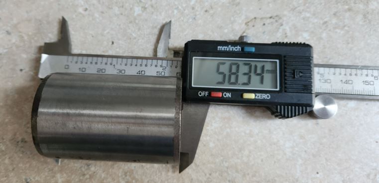

Note that the wrong bushes were utilized at some point in time. The OEM bushings are 1 piece 58mm in length! Hmmm, I wonder if that caused them to wear out being wrong material?
Anyway I used some rotary wire brushes and sanding drum in an air rasp to smooth out the sockets for the new bushings and they came out of just fine.
I've got some welding to do on the left arm on the bottom - a piece of the bottom of the left arm "cover" is MIA! Who knows.....

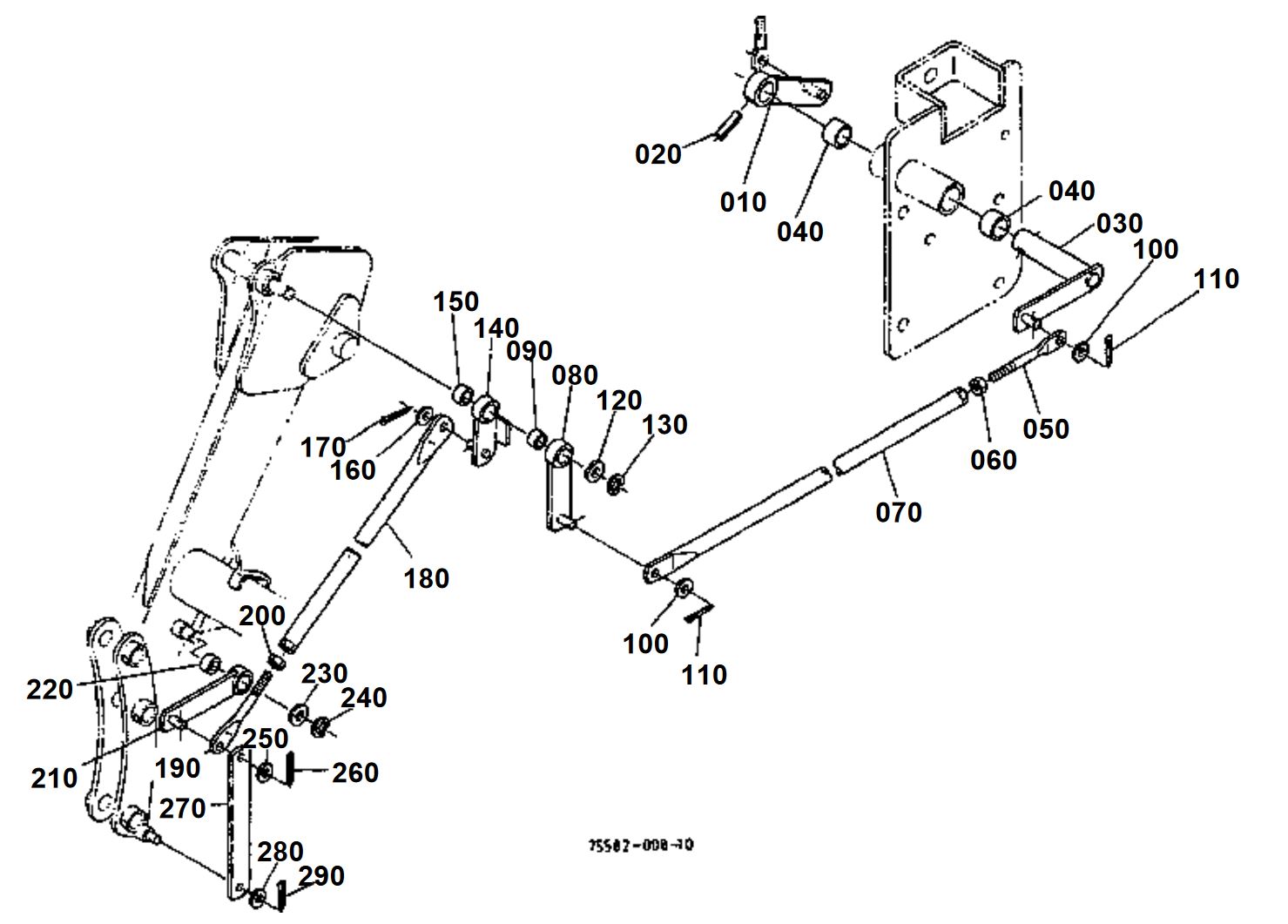

Next will be the rebuild of the links for the self-leveling system for the bucket in the last pic.
