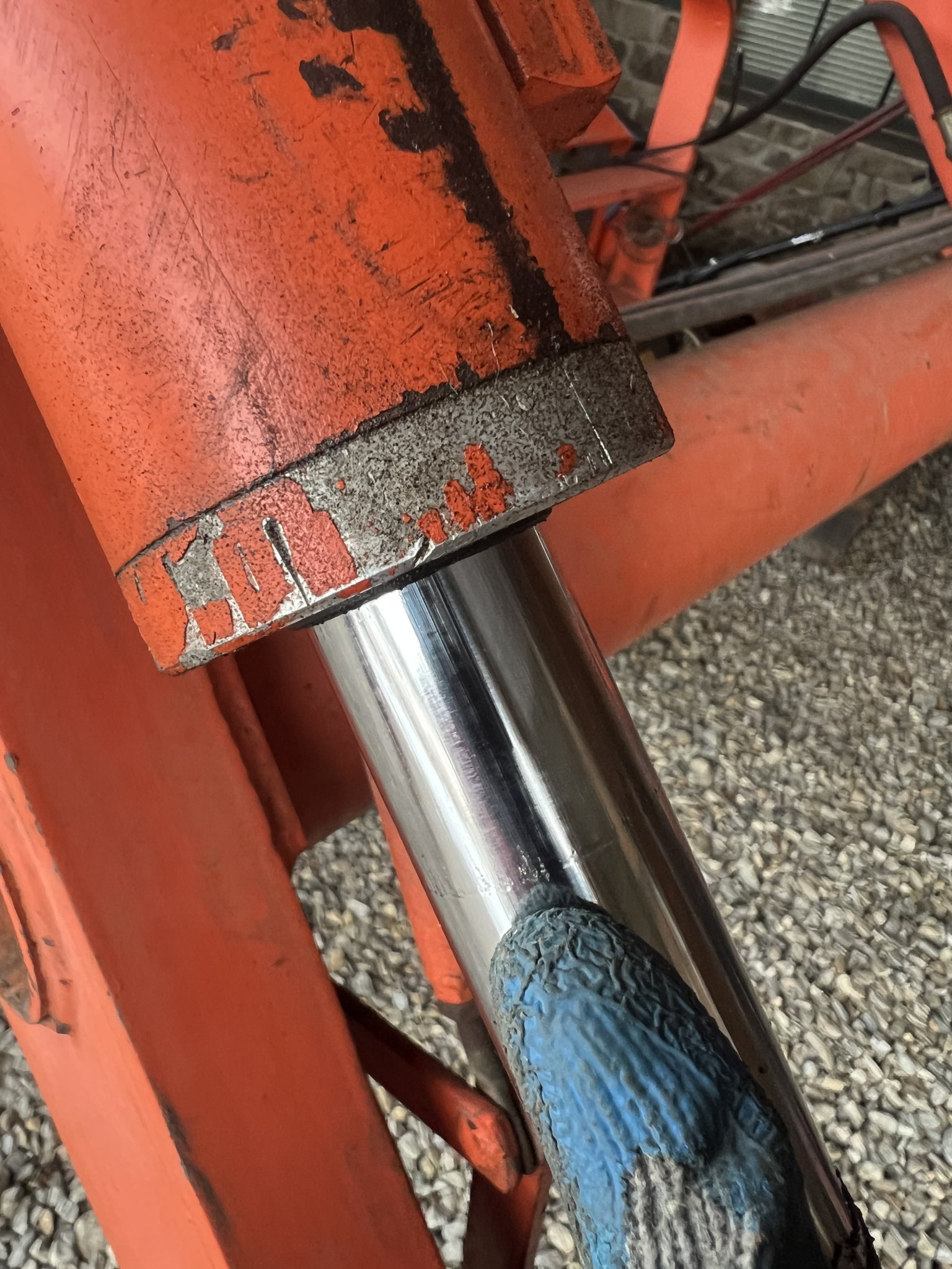

So I saw this post the other day but held off on commenting til I could check out mine. I’ve always noticed a bit of play like you describe so I checked it out this am while loading some firewood racks. I flopped the bucket by hand and you can see the line left on the cylinder from where it traveled. I’m not saying it’s wrong or right but it is somewhat common apparently.
