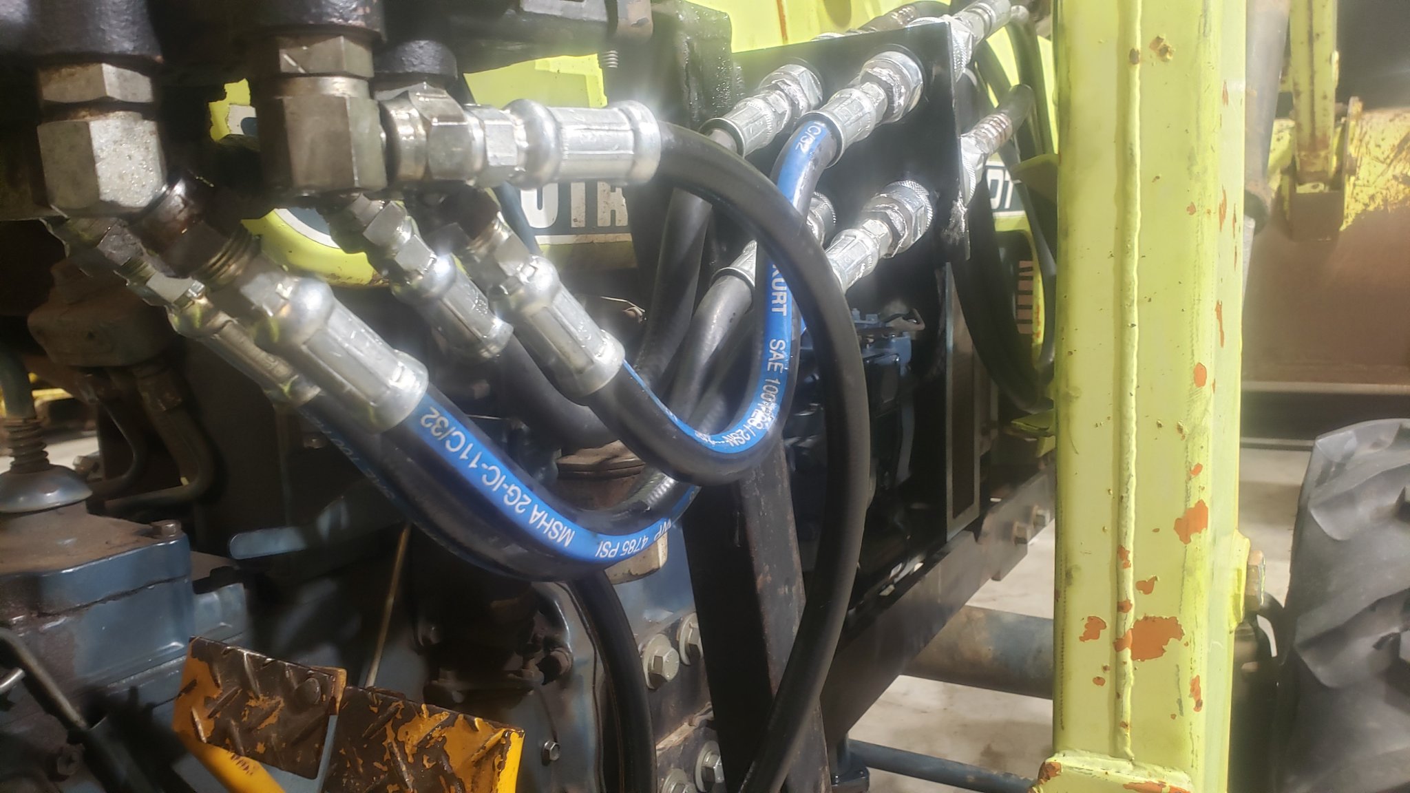

I am tasked with the repair of a L345DT. This has been a challenge for a while now, but the pertinate part for today is the loader and it's associated hydraulic system.
This machine has what I would call power beyond feeding the loader valve. This is an open center system, Power beyond pressure feeds the IN port of the valve, OUT port goes back to the other side of the power beyond valve. Loader mast and bucket hoses are attached to each spool as they should be.
Now, my buddy says the loader worked ok before any of this happened. I agree, I saw him use it.
He broke the motor, removed the loader, I split it and repaired the engine. It's all back together now and he wants some quick couplers between the loader valve and the loader. That's what I"m working on now.
I have it all hooked up again. The loader acts as if its trying to return under pressure. The 3pt hitch works as intended in all respects. This 345 has a single engine driven gear pump and the power steering works properly.
I didn't remove the loader, and my friend doesn't remember all of the connections to the loader valve, it's been a few years. There is a port on top of the transmission with a plugged fitting in it. He isn't sure but thinks there might have been a hose routed there from the valve. That would be a return line, but doesn't know where it came from on the valve. I'm not sure that it needs a separate return, my experience is in green ones, and they don't use a second return line. It's acting like its under pressure on the return side, but that doesn't make sense to me.
Anyway, is there any way one of you guys would happen to have a schematic for this setup handy?
I can take pics and provide any specific info needed to assist your diagnostics.

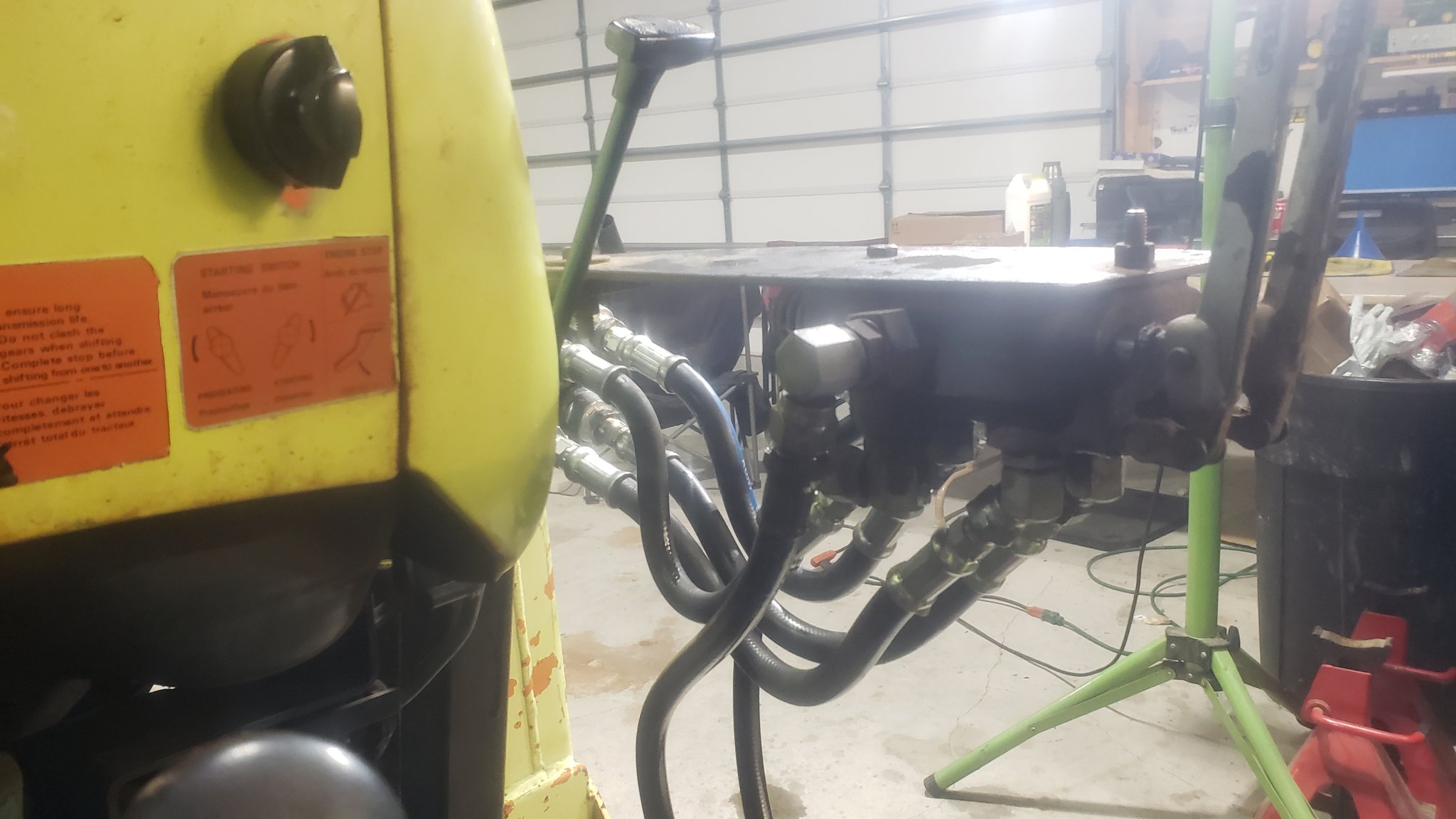

There are 6 hoses. 4 to the loader, 2 run to the power beyond.
Left side of seat, aluminum block, hose fittings are on the top of the block.
I can provide pictures in the morning.
I would expect that power beyond simply inserts itself into the 3pt hydraulic circuit and flows oil normally when no hyd functions are being used. If the loader is moved, the 3pt wouldn't move, or only enough flow to do 1 thing at a time, What I don't get is if the 3pt goes down fine, doesn't that mean power beyond and the 3pt are basically a pressure free return? Wouldn't the loader valve just direct return oil to the power beyond, then flow through the normal 3pt return system? I guess my real question is, what is that sump return in the top of the transmission for? Why is it there and/or, do I need to use it?

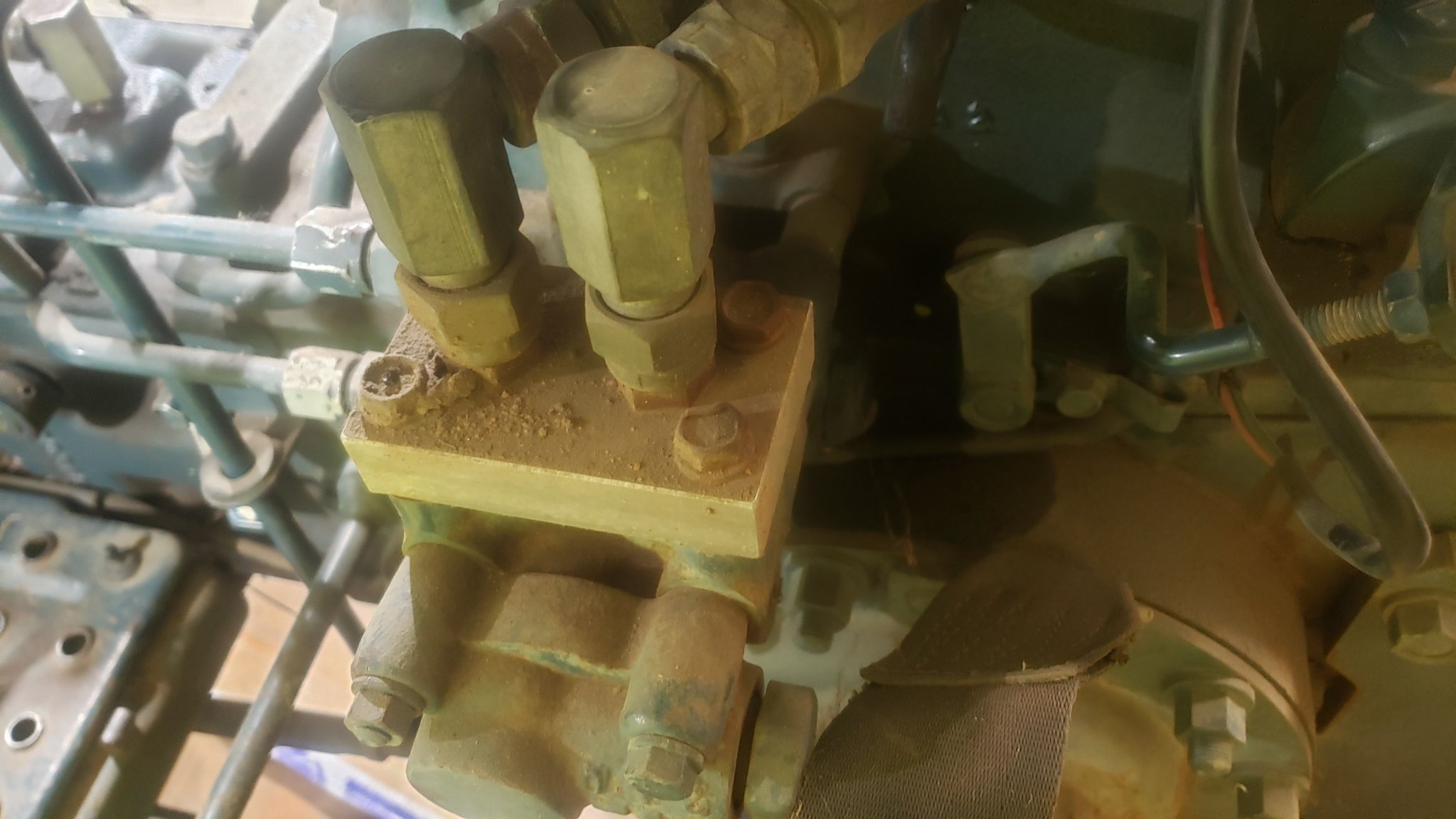

That block you reference does not exist on this L345DT.
I have a power beyond block on top of the 3pt valve and 2 lines running to the steering box for power steering. After that is the sump inlet, filter pump and pump pressure lines.

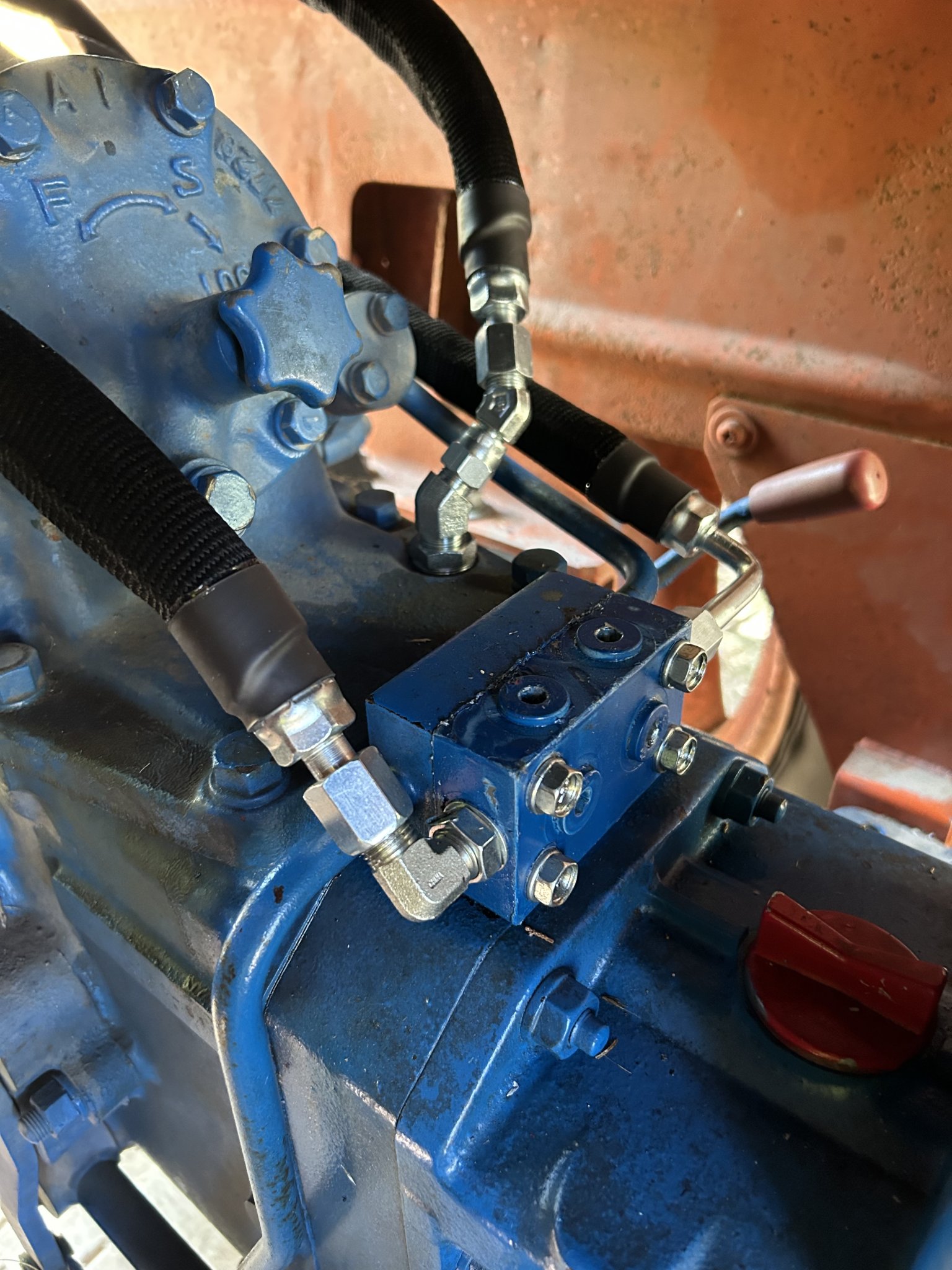

Here is a picture of the adapter block from my L185
The hard pipe on the left is pressure from the pump. The 90 degree elbow on the near side is still the pressure side and goes to the rear valve power in. The hose on the far side of the block (with a 90 degree hose end) is the power beyond from the rear valve. The hard pipe on the upper right goes to the three point hitch valve.
The hose that has two 45 degree fittings is the tank return from the rear valve. There was a plugged port in the tractor that was available for use.
The picture is from the brake side looking back towards the seat, The block is under the front of the tractor seat on my tractor.

I put that together because he wanted the quick disconnects, so I'm sure of the hose connections to the loader. I know I haven't cross connected the mast to the bucket and yes, I've done that before and it does make things wonky.
The line on the side of the valve, both of those run back to the power beyond plate attached under the seat on top of the 3pt valve. That's the source and return for the loader spool valve.
Those quick disconnect fittings are new from Bomgaars, so, I'll look at that closer. I expect them to work, but New doesn't always equal good.
The issue is basically that nothing really wants to move, extend or retract, it's giving me the appearance that the entire system has pressure on both sides of any function at the same time. That behavior is making me question the return side of the system. I know I have pressure, but it seems like I can't get oil out of the valve. There isn't any issue with pump loading or squalling relief valves while the loader valves are in neutral. This isn't making much sense yet.
