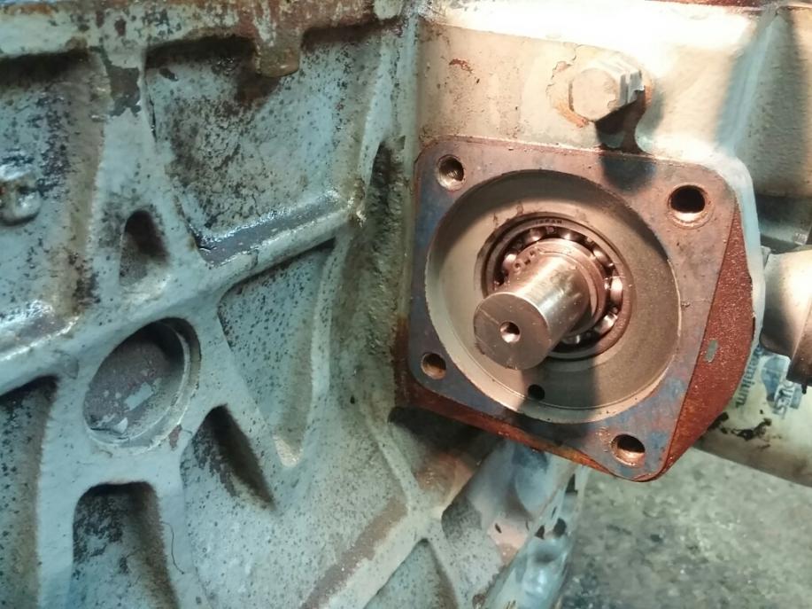

I am swapping a v1702 in place of my v1501 on an l345dt. I have the oil pan, mounting plate, starter and flywheel all swapped over and it fits nicely. I went to swap the hydraulic pump and found that my industrial v1702 does not have the splined tailshaft on the fuel injection pump that I need to drive the hydraulics. I've looked up part numbers for the cam on the l345dt and on the l355 (has a v1702) and the cams are different part numbers.
Heres my question. Any suggestions on where to source the proper fuel injection cam to drive my hydraulics?

I'm sorry you are right, it's a V1702A in a L355
Now that leads to the next point that they have the same hydraulic pump so they should have the same cam setup.
I now wonder if you have a newer V1702DI-A motor or some other variant.
Pictures of the hydraulic drive are needed now.
Also take a picture of a fuel injector, that might help with the identity of the motor.
34,361
9,591
It is the older V1702 not the L2850 V1702DI-A, I just don't know if it's a the A version or not.
On your V1501 did you pull off the pump multiplier when you pulled the hydraulic pump?
Do you still have old motor there?
If you do, take a picture of it's output from the fuel cam on that motor.
34,361
9,591
Having done a little more digging, it doesn't look like that shaft was setup to drive a pump.
On yours there should be a collar and a gear and an E clip that holds the gear to the shaft.
Besides that shaft not having splines it also has no slot for the E clip to go on it.
It should be possible to get the fuel shaft and replace it with the right one.
but it's not a cheap part.

You are correct. The old motor has a splined shaft and an extra gear held on by an e clip. The v1702 has a smooth shaft that is a lot shorter than the splined shaft on the v1501.
I do still have the old motor. I will get a picture this morning.

This morning I talked to a guy at West Kentucky Tractor and he has run into this before. He has the shaft I need on the shelf so I gave him my Visa numbers and the shaft is on the way to Oregon. I will keep you posted.

My new cam arrived and I put it in today. The splined tailshaft was slightly different than the v1501. It was a little shorter. So I flipped the gear that is held on by the e-clip around and cut a new shim. It now engages with the hydraulic pump drive offset. Now I will have hydraulics on my new engine! Now I need my stop lever to arrive.
