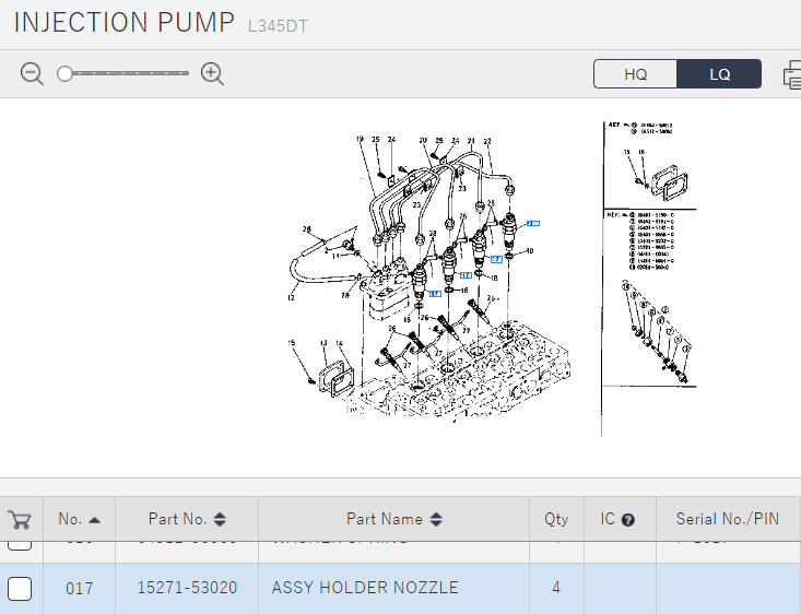

Hey all - been reading on the forum and decided to join up. My dad and I are working on a L345DT that he picked up a couple months ago. Aside from a leaky hydraulic cylinder it operates pretty well but seems to need glow plugs and possibly injectors.
I THINK we've found the injectors we need but what gives us pause is that everything we can find references the V1501 engine. However this tractor is stamped as having the V1501-DA. I'm not sure what the DA designates and I feel like I've read everything the internet has to offer on Kubota engine model number suffixes. I do know they made a marinized version of this engine as well.
So really there's two main questions here - are we on the right path for the injectors? And does anyone know what the DA stands for? (mostly just curious on this if it doesn't make much difference to ordering parts)
ETA the injector number we think is correct: 15271-53020

Your Kubota dealer can probably get them for you. Since you are not 100% sure I would use the dealer to order the correct parts numbers based on the serial number of the tractor.
Kubota USA states 17391-53000 is the injector for the L345. It looks like this and clamps down into the opening. $165 each and two available at Messicks

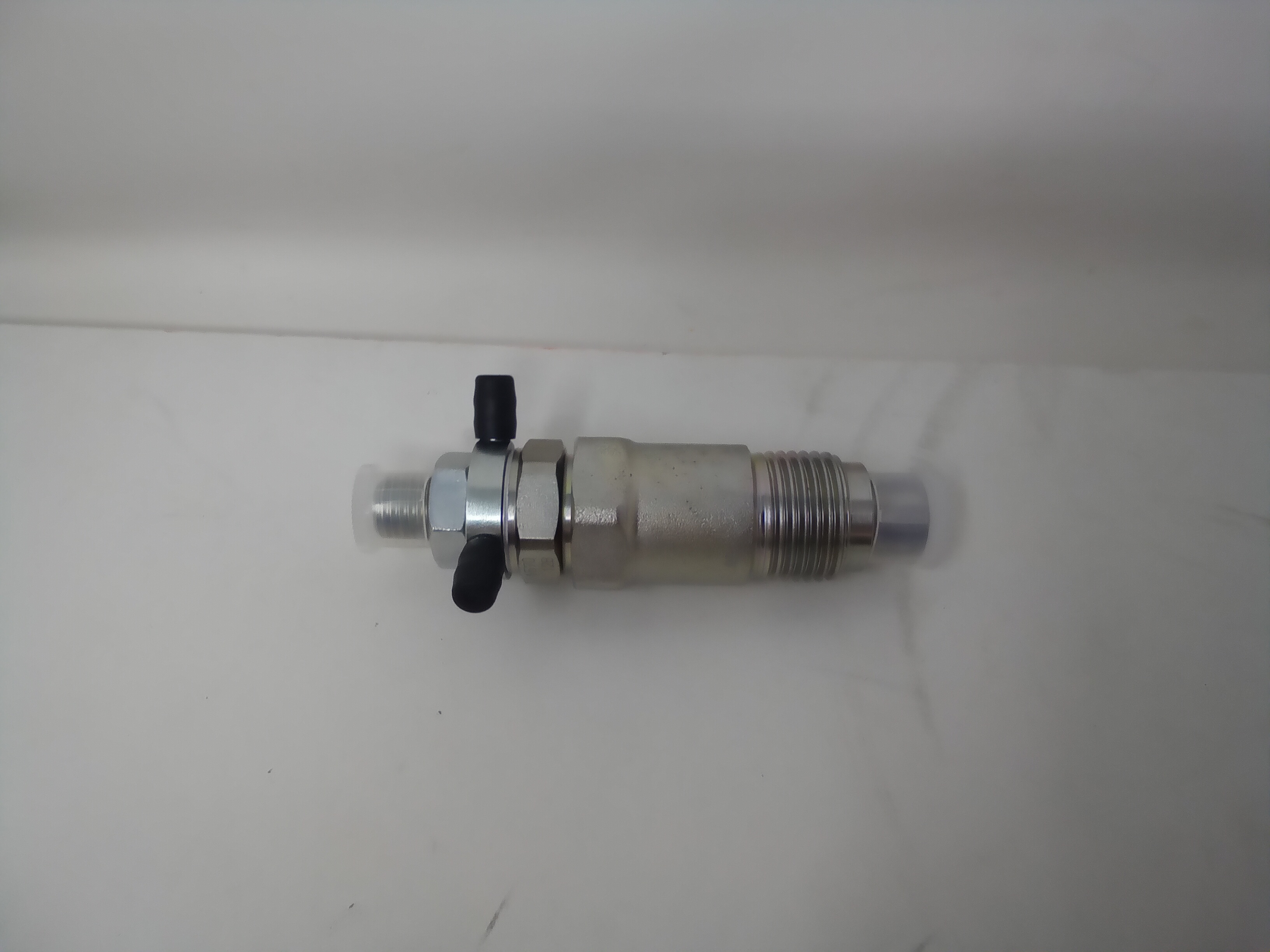

15271-53020 has been superseded by 70000-65400 HOLDER. Looks like the picture below
There may be a different part number for some injectors if the bypass hoses connect differently (black covers on connections shown below) on the injector. I think the first one only needs one connector that goes to second injector that goes to third injector and fourth that goes to the fuel tank. Shown below are the second and third and fourth
" Kubota USA states 17391-53000 is the injector for the L345. "
99% sure you were looking at the L3450
Because that is a DI (direct injection) injector.
The L345 is not a DI engine it's a IDI engine.
The injector number that he gave and that I gave is the right injector.
You don't need to get the Injector with the superseded number, nothing changed.
And the bypass fittings are reused from the old injectors.

Dang it I guess I need new glasses.
I didn’t realize Kubota reported both the L345 and the L3450 when searching for the L345 but you are 100% correct
I will edit my post above
