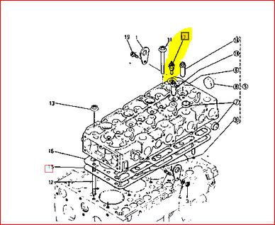

Quick easy check, turn the key to on, but not running, the temp sending unit is located on the right rear of the head, remove the wire to the sending unit and touch the wire to the metal ( called grounding) on the head, look at the gauge.
If it's gone up, usually all the way, the gauge and wiring are good, it's the temp sending unit is bad.
If the gauge still does not move then look at the color of the wire go to the back of the gauge and find that wire, use a jumper wire and ground that terminal on the gauge, if the gauge goes up then it's got a break in the wiring, if not then you will need a test light and check for power going to the gauge.

New block should work with old sensor (go easy on the thread sealant so it doesn't insulate the ground). Also check that the coolant level is up near the radiator cap. If it's not high enough to wet the sensor it can make the gauge goofy. With the four dash screws removed, the dash will lift up a little, limited by the hour meter's mechanical drive cable. Undo the threaded collar that holds it into the bottom of the tachometer and the dash will go up further. Reattach the cable later after the temp gauge is sorted out. Wiring diagrams for L345 and L355 attached. (nearly identical - L355 reads better ) The wiring gets really dusty in there and hard to identify colors & stripes. You'll solve it. Take care, Dick B
