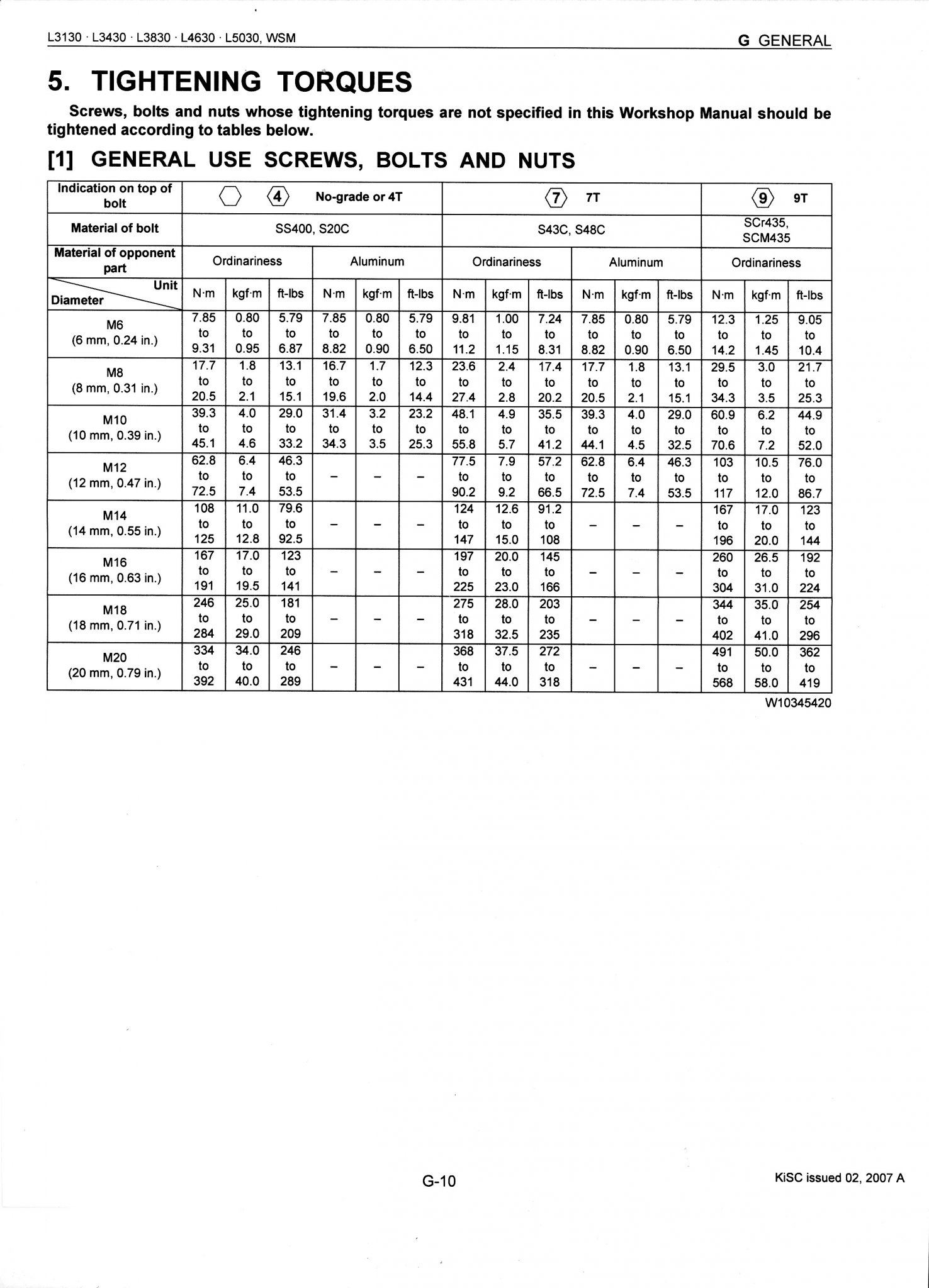

Another related question. Kubota has a torque rating for these bolts of 35 to 41 lbs. When not able to use a torque wrench I tighten it to what I think is enough which is probably on the light side. 35-41 seems like of lot. Does anyone know how to judge more accurately without breaking the bolt?
The torque for the fuel lift pump mounting bolts is 8.3 ft. lbs, not 35 to 41 ft. lbs.
Thank you for the response.
I have attached a chart that I got the #'s from. I did not find a specific torque for the lift pump. A #7 is on the 10mm bolts holding the pump. Where did you get your numbers from? I would rather use specific #'s for my pump but it is probably a mute point since I will hopefully tighten it enough. I have a torque wrench but it

If I remember correctly, the wrench size to remove the nuts holding the pump on is 10mm. That would make the stud 6mm. If you look at your chart, 6mm stud or bolt in Grade 7 under ordinariness is 8.31 ft-lbs.
