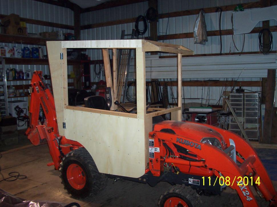

I built a wooden cab for my bx24. I ripped 2x4's down to 1 1/2" square for the framework. I used 1/4" sanded plywood for the skin. (If I had it to do over I would use 1/4" luan). I used 30 mil vynil for the Windows. Total cost was about $150. The front and rear Windows I put on with industrial self adhesive Velcro, so I can remove them in the summer. I can also pull the door hinge pins and remove the doors. It's not something I'm going to take to the fair, but it works great for me. Keeps me nice and dry when I'm plowing snow. I got a little 12 volt heater from harbor freight for $9 and put it in and it keeps it nice and comfortable.
This is an unfinished photo.
