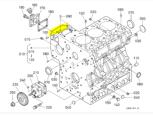

There is a quirk to that model of tractor, they actually used 2 different engines during production.
So to start with, you need to get the tractors serial number and the Engine model and serial number.
The engine model and serial number can be found stamped on the flat just to the side of the injection pump facing up.
