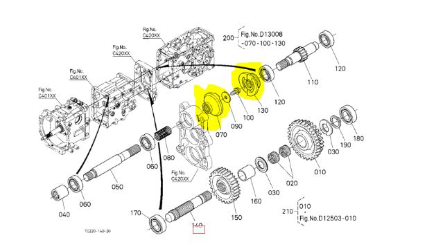

Lets back all the way up.
The PTO should never grind on that model because when you are engaging the lever you are engaging the one way clutch (Cams) not gears.
And if it is truly grinding then something else has come loose in there and it will need to be split and looked at.
My suggestion is make a video with good sound post it on you tube and give us a link to be able to hear what's going on with it.
Most likely you have rounded the cam teeth off with trying to engage it with it spinning and the only fix is going to be to split it and replace the one way clutch.
The One way Clutch:

Bingo, that's the sound I wanted to hear, cams are shot!
Get the WSM and split it!
