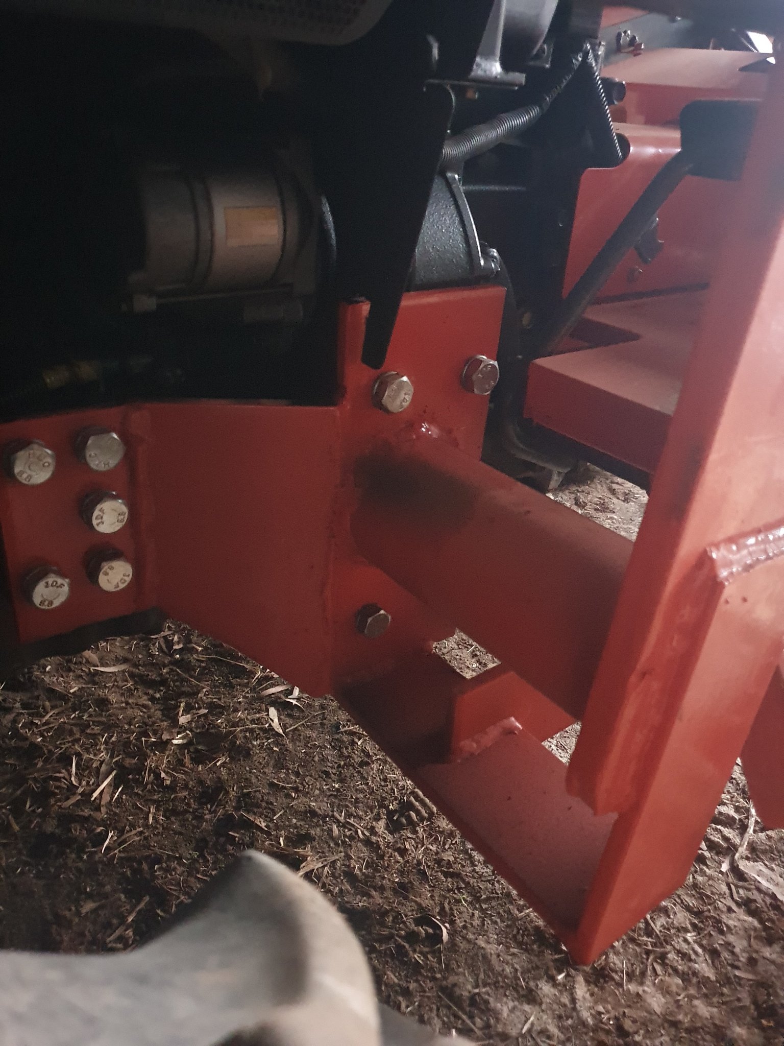

So I've got a plan for the sub frame. Looking good. But weve come to the bolts. They appear to be 16mm metric. (We've tried UNC and UNFand they were clearly not right)
But the metric after one turn gets super tight.
Any one know for sure what the thread is? Is it just made right?

Looks good! What did the bolt thread turn out to be, just a different pitch metric or paint in the threads? I see they have metric making on the heads. I am still liking that self leveling bucket setup.
