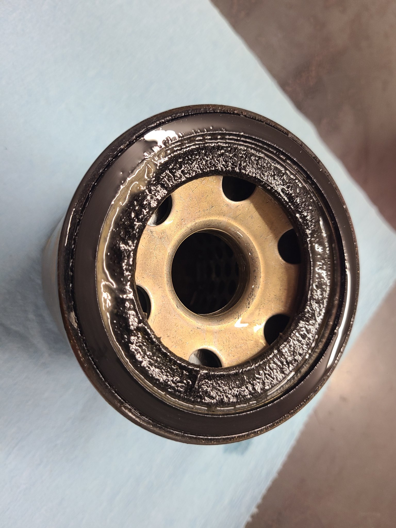

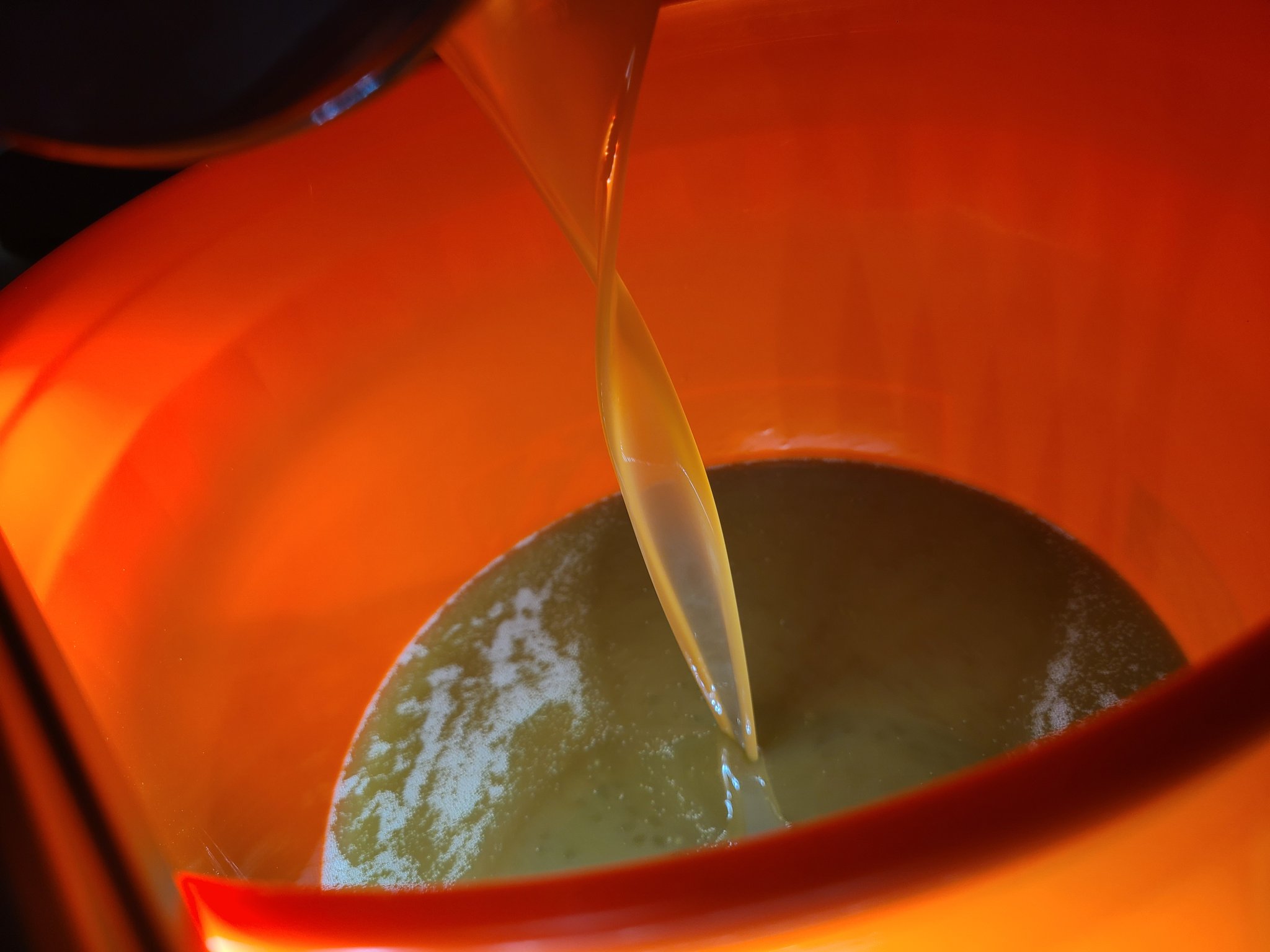

Broke the hydraulic filter loose and drained a 5 gal bucket of fluid out. Fluid looked ok to me and the magnetic pickup ring in the filter had an expected amount of debris on it (IMO, original fluid with a few hundred hrs will have some anyway)

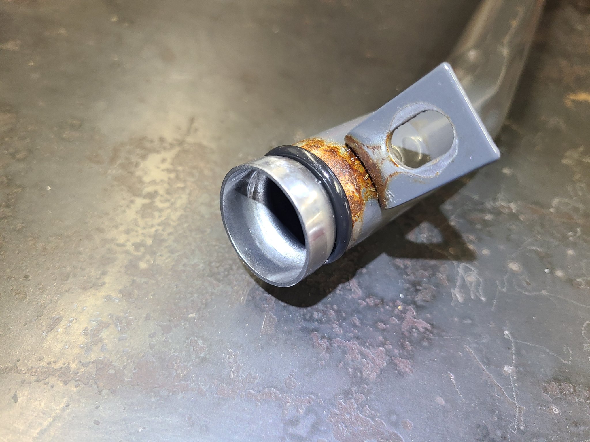

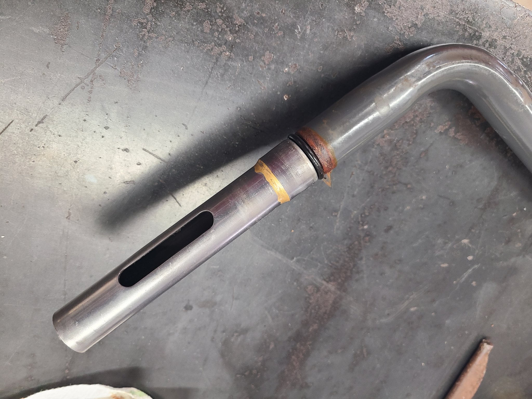

Thats a lot of crud in the filter. Replace the filter and also remove the suction tube I pointed out in post #13 and clean the strainer.

You have pressure sufficient to easily pick up any of those loads. Remove the suction tube I pointed out in post #13 and clean the strainer.
That's what I'm working on now. That pipe goes into the gearbox housing a good 3+ inches so I'm having to take multiple things apart to get it out.

I'll have to get a new filter on Monday and while I may catch some flack here, I'm planning to continue running the same fluid. I captured it in a clean bucket and covered it with a lid. It will get strained going back in.
I don't feel like I've found the 'smoking gun' I was looking for, so pouring any fluid back in right now doesn't seem like my next step.

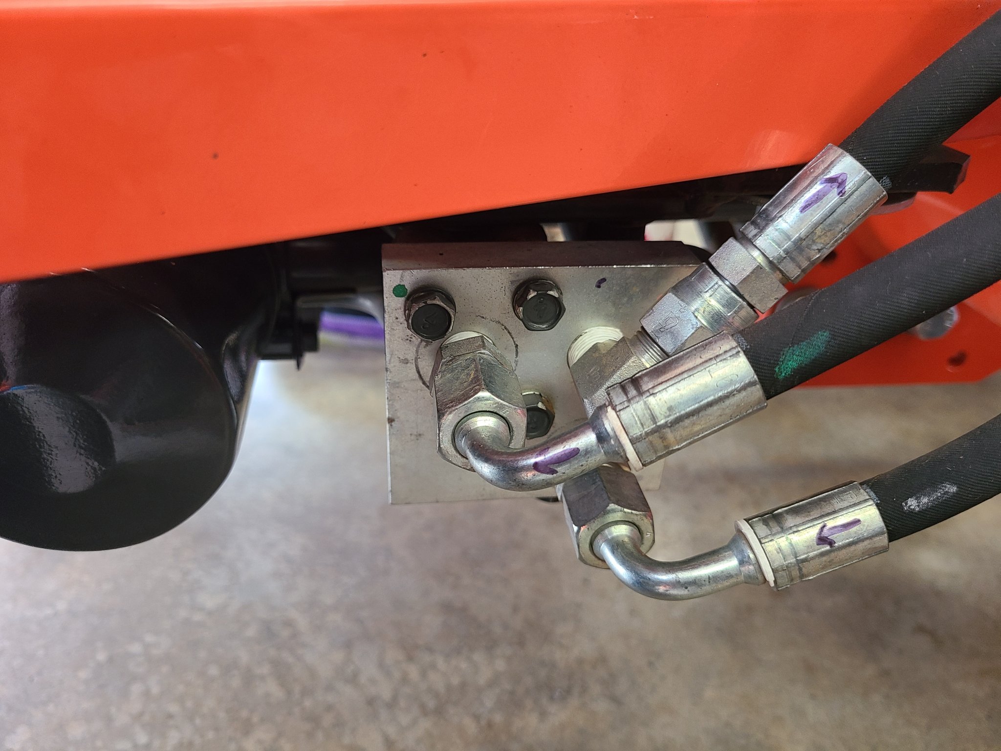

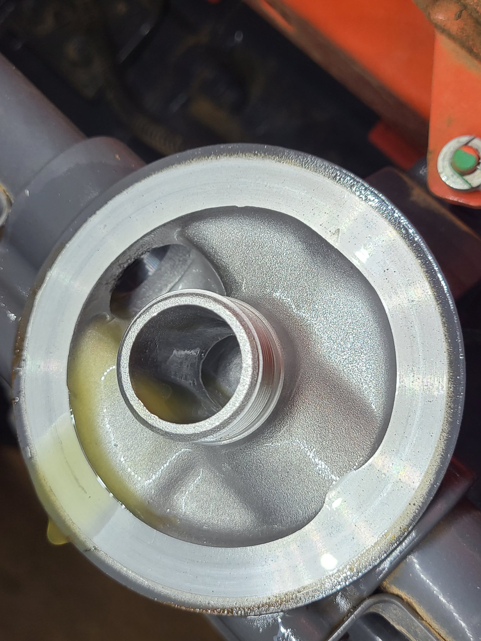

Which line would you recommend to test flow? Would the PB block (out) to FEL (in) work? (Top right fitting in picture)
I want a new filter before I dump fluid in and perform a flow test so I'll pause here till one day this week.

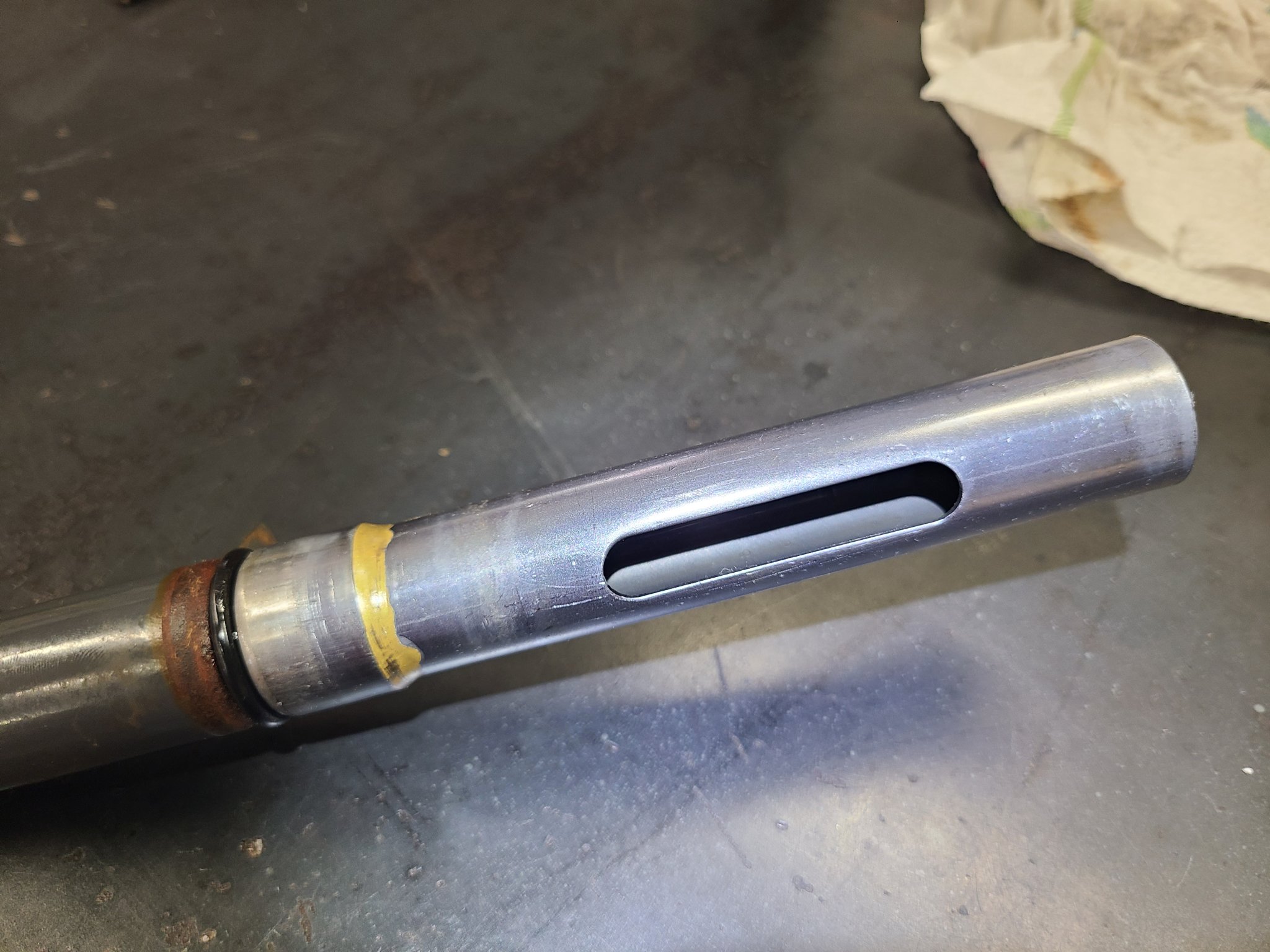

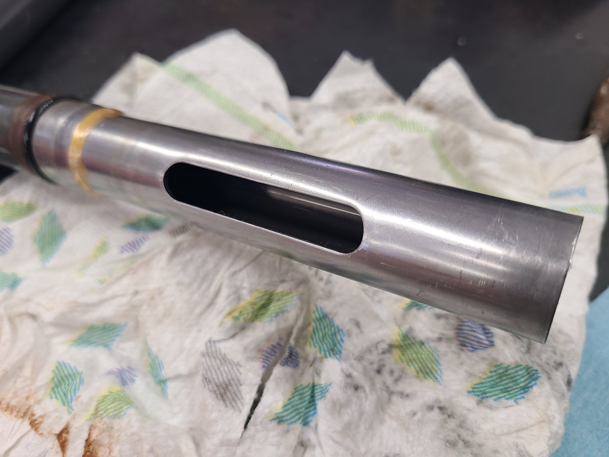

I can’t be 100% sure but I don’t see a screen on that pickup tube, but I think I see one on theoldhokie’s picture in post #13. I doubt that it really matters since it is filtered through the spin on filter.
1) Is there a screen on either of the pick up tubes?
2) Would it make any difference if the screen is missing?
I would have excepted to see something finer that that opening size to keep larger debris out of the tube.
So I suggest that you run a string with a small piece of rag through the tube while it is off. Just to be sure it is open.
