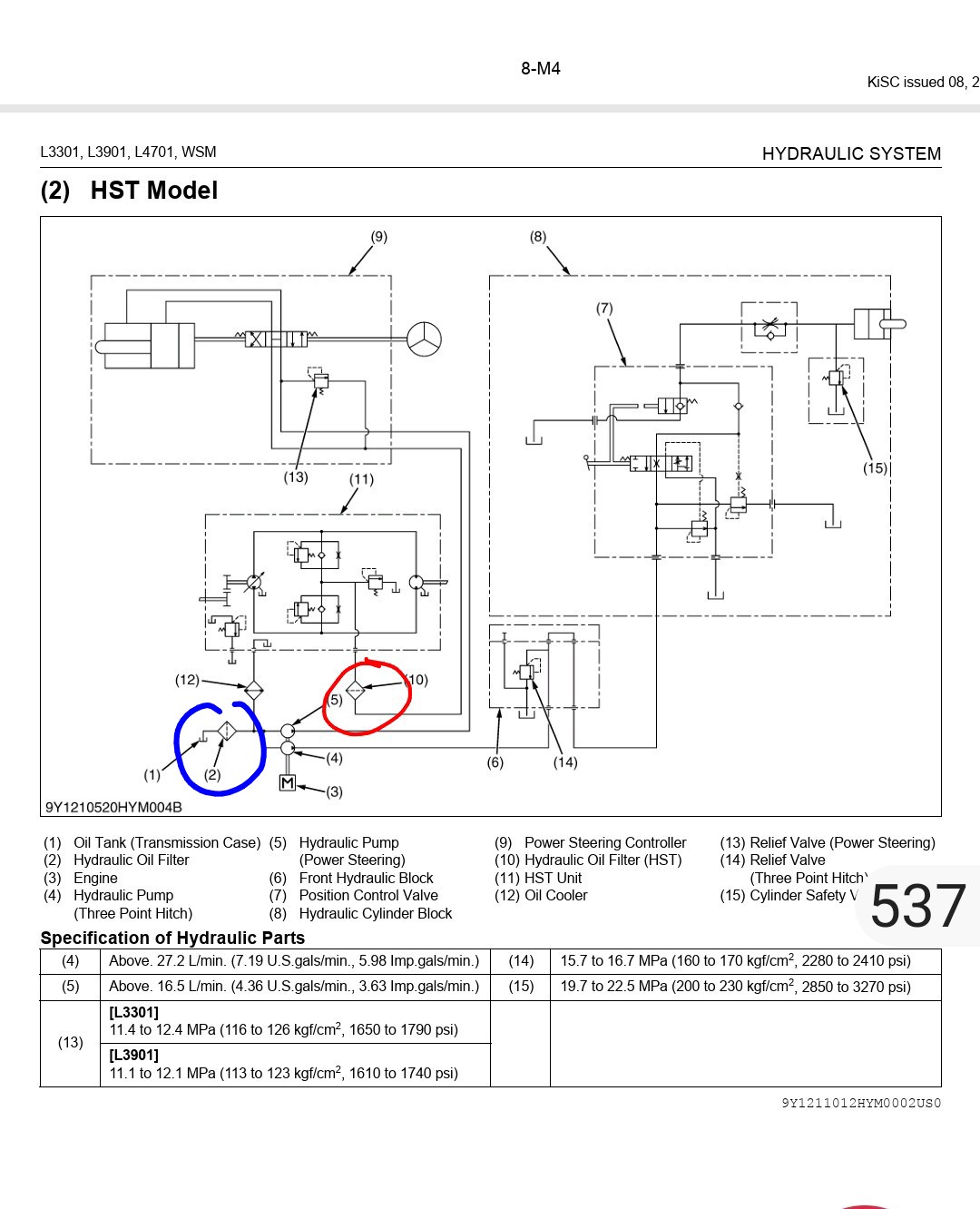

There are two hydraulic filters and two pumps.
The suction filter is ahead of both pumps and never sees positive pressure.
The HST filter is after the PS controller snd ahead of the transmission. It sees HST charge pressures.
Those two filters are not interchangeable
Consult the WSM for circuit diagrams and pressure testing procedures

Look at the hydraulic circuit diagram.
That filter is fed by the return flow from thd PS contriller. The filyet feeds the HST and from there goes to tank. The HST controls the filter pressure subject to the maximum PS relief @ 3000 PSI.

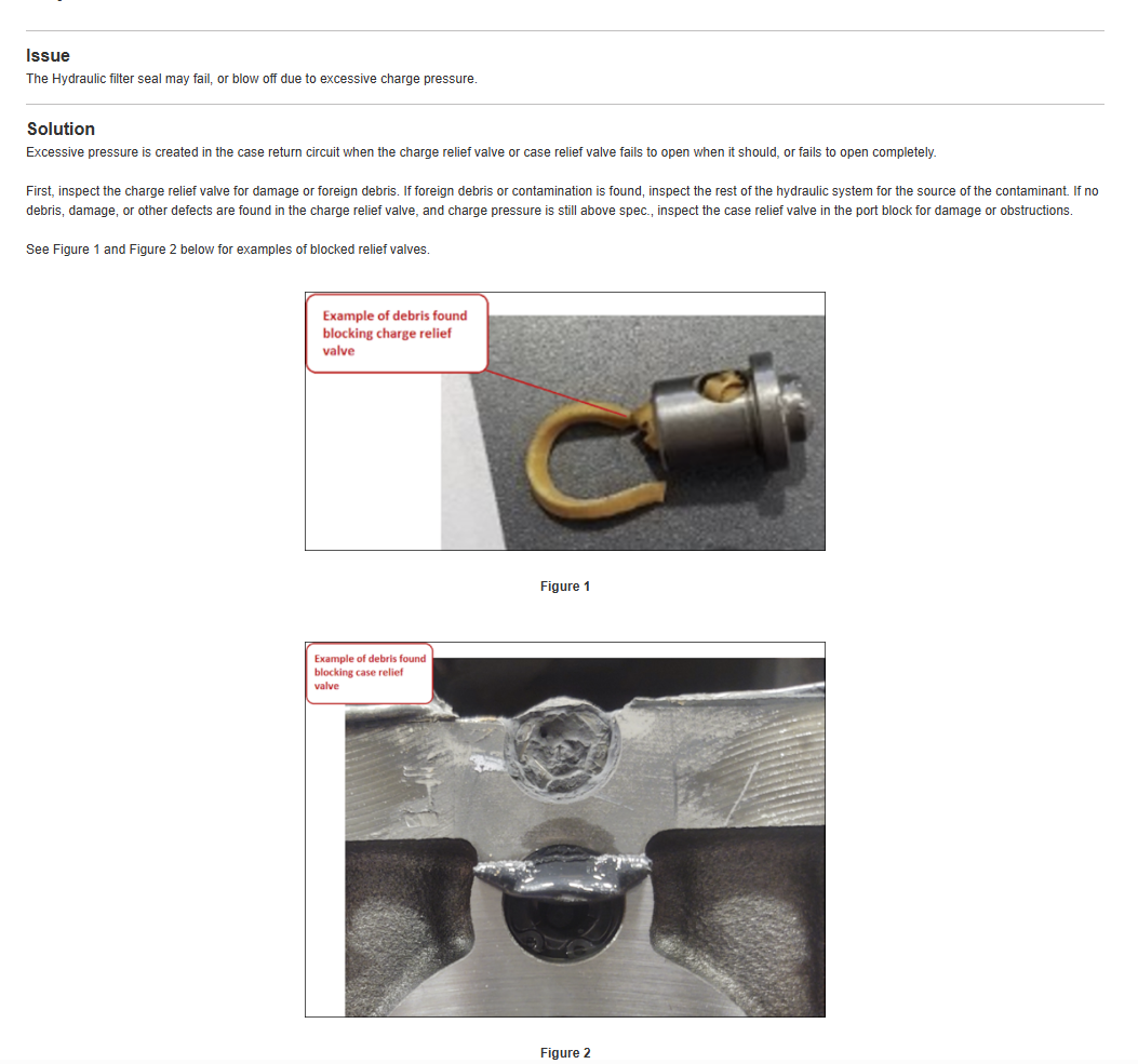

If the pressure relief in the HST is malfunctioning it will cause this situation.
Get the WSM and inspect the pressure relief valves, there are three.

The oil goeS to the HST. I am not sure about the L3301 but on others it is used as charge pump pressure. Read the WSM - its free and full of details!!!

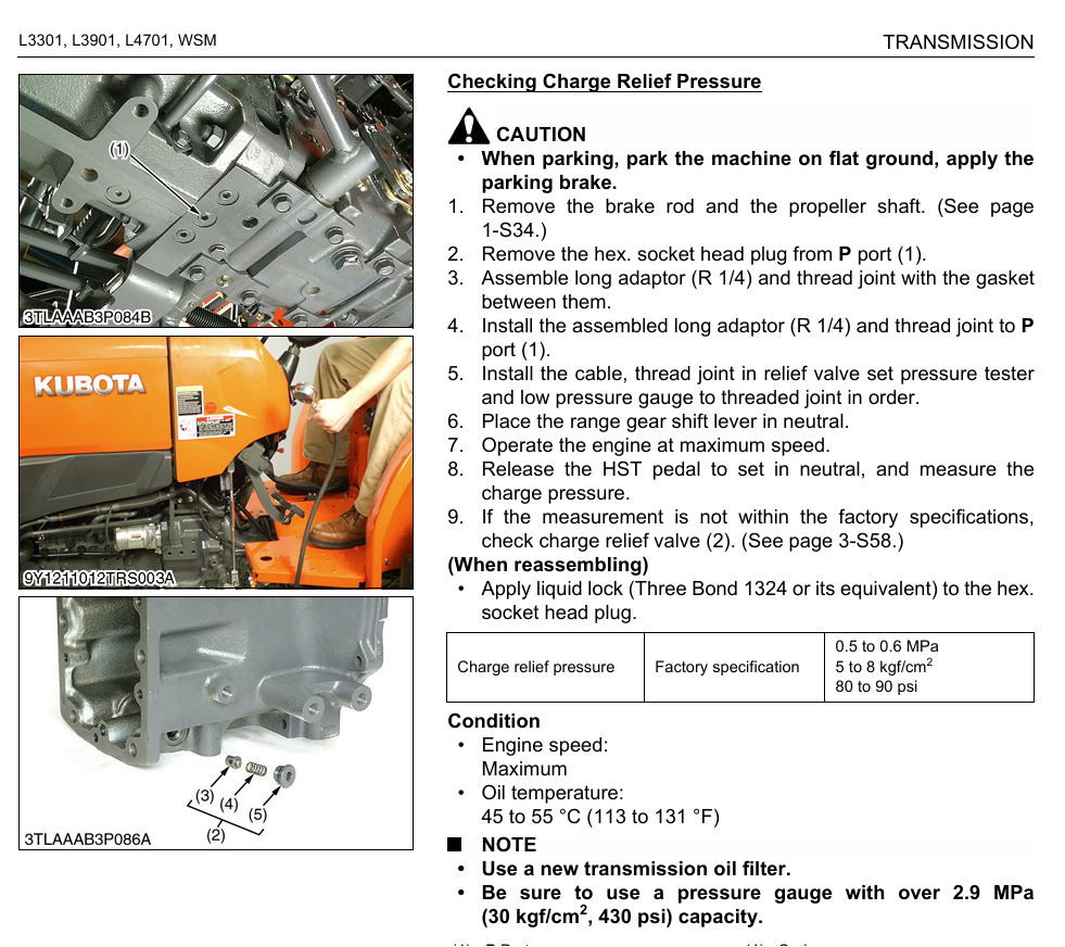

I've located 2 relief valves. One next to the hydraulic suction filter and one on the side of the transmission. Both seem to be ok and no foreign objects in the valves. Still looking for the third relief valve.
The third valve is between the other two. To access it, you have to remove the propeller shaft going to the front axle.
