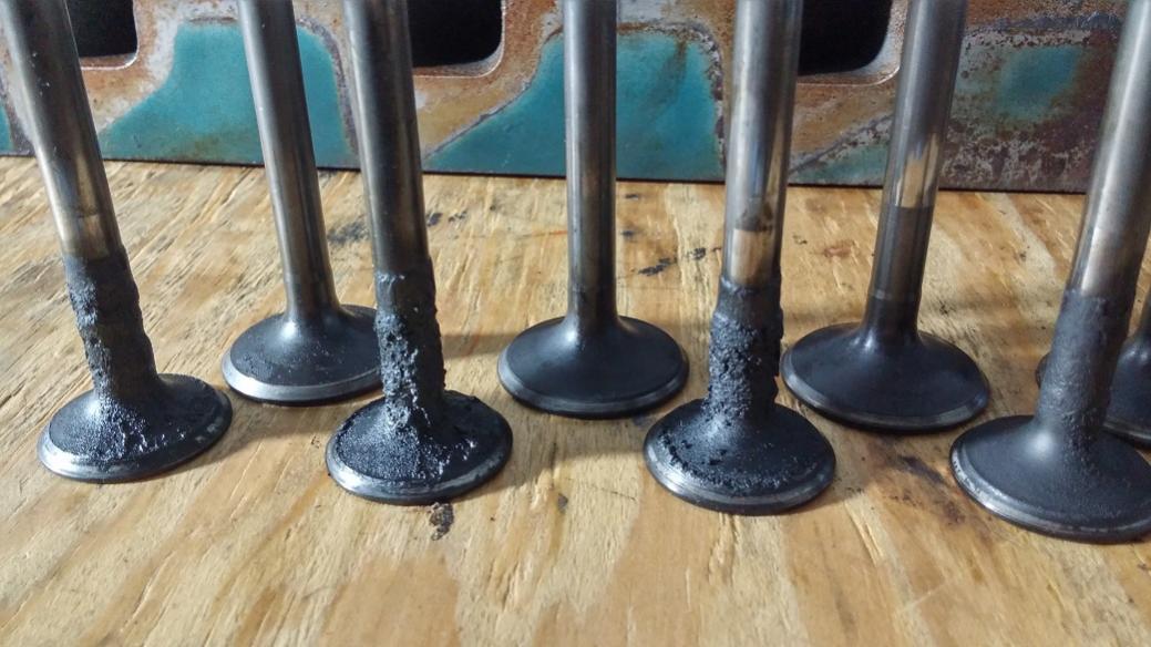

Okay got the head off poured fuel into the ports as suggested. the intake ports look pretty good but the exhaust ports started leaking fuel only after a few minutes took the valve off and was shocked as to how much carbon buildup there was on the exhaust valves
I took several measurements and so far all measurements are well within specs I measured the cylinder bores and they looked great.

I think your right about the fuel. When I started having compression issues I should have drained out the old fuel and refilled with fresh fuel. Never did that step. Still happy I pulled the head. I uploaded a JPG of the valves. The engine side (seat??) looks just as bad.

The valves show a high presence of oil getting into the combustion chambers and depositing on the exhaust valve stems. The rings are obviously not seating correctly - most often due to excess wear but sometimes a result of incorrect rebuild and fitting. It would be great if the original owner could describe the engine's history with detailed symptoms, the testing done, corrective measures taken, and measures deferred. Unfortunately the details aren't available so the only real answer to the smoking is a thorough inspection of all its current measurements and fits. I think oil temperature may be getting high after running because of exhaust blowing by the rings. It's possible a rebore and oversize rings are needed to make it right. Need to decide if the symptoms are bad enough to justify a deep dive. Best luck, Dick B.

holy smokes I guess providing a picture was a good idea your diagnosis does explain why a fresh oil change doesn't seem to keep the engine quiet for very long. And I thought the buildup was just me running the tractor cold
Was hoping the feeler gauge results might have saved me from pulling the pistons. It did go pretty deep down the pistons probably hitting the last ring on All 4 pistons not that I know what I'm talking about. The Pistons do have some play in the liner around 1/32".

There is also the possibility that the valve, valve seats and seals are bad. ;)
10,334
7,368
I had that issue with a small block Chevy as a kid....that was 40 years ago, but still thought about is when I saw your picture.
Would bad seats/seals would hit both the intake and exhaust valves equally, or there would at least be some build up on the intakes and more on the exhaust, due to the heat?
These intakes look clean - exhaust, not so much...
Just trying to learn as well, without highjacking his thread.
