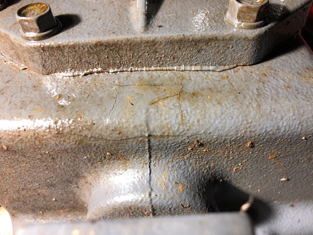

First time poster here with a big question/problem. My father bought a new L3240 8 or 9 years ago and didn’t use it much. Since it left the dealership it’s never spent a night outside, the tractor only has 70 hours on it. Long story short, my father passed away last fall and we went to get the tractor out of the shed the lift wouldn’t work (dad had a tiller attached). The tractor would drive though. We immediately noticed that hydraulic fluid was leaking from the bottom of the rear end. Even after shutting the tractor off fluid continued to leak for hours and filled up an old hubcap. I crawled under the tractor and saw hairline cracks on the bottom of the rear end. I’ll try to add a picture tomorrow . What could have caused this and what can be done to fix it?

Nice photo....Definitely hairline cracks in the casting. Possibly these are older cracks based on the rusty color within the cracks? Or is that maybe the color for hydraulic fluid??
Probably these are thermal cracks related to the casting process at the foundry. If you are definitely sure this is the specific source of the hydraulic leaks, brazing the cracked area will most likely seal it from further fluid leaks. You might want to double check to make sure these cracks are truly the source of hydraulic fluid leaks.
Best of success.

How about another picture, further back so we can see more of the area around the previous picture?
Without seeing the bigger picture, I'd be thinking of taking a carbide tip in a die grinder and cutting a groove where all the cracks are. Use something like either to clean the area and then use an epoxy to put in the cracks.
Might sound silly to some, but I've done just as I described on the side of the engine in a John Deere 350 crawler. Used JB weld. Put duct tape on the lower side and when the product was in place, pulled the tape up to make a form to hold the epoxy until it set up. We left it for a couple of days, and the guy used that machine for at least 8 years that I know of.
If the metal is not under pressure and taking a strain when being used, it will hold fine.

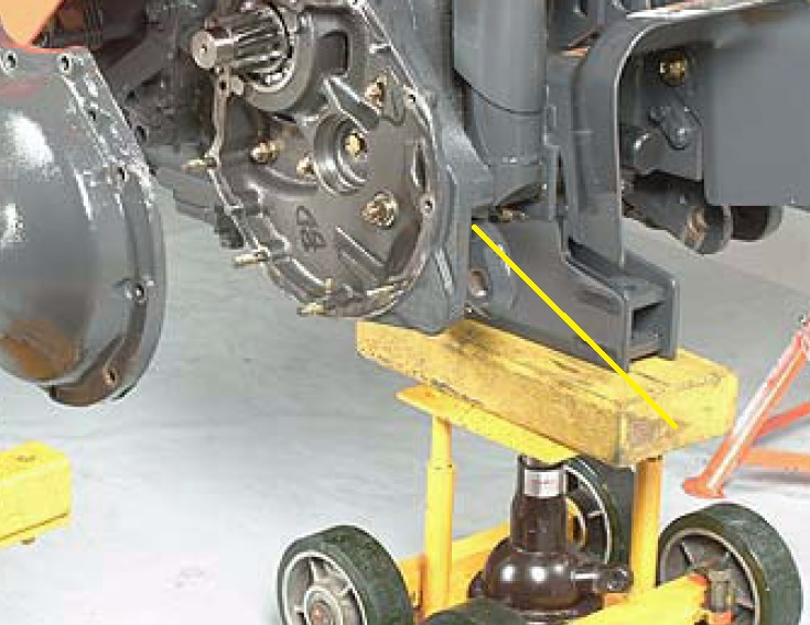

From looking at a WSM photo, I am wondering if the cracking is around where the lower 3 pt arm connects to the rear end.
In the photo supplied by the owner, a bolt on bracket looks to have moved enough to break the paint film.
If in its earlier life the tractor was backed into something where a lower 3 pt arm delivered the shock load to the rear end of the tractor, it could explain the damage.

It looks like cracked paint to me. Can you get a picture of where it is leaking?

I've draw a circle around the area where the crack is and the fluid is coming out. Note this is the very bottom of the tractor and not near any stress points where the 3 pt hitch connects. The bar that runs into the top half of the circle is the drawbar for reference. And the drawbar couldn't have caused the crack it's below this point of the case, even if it did somehow get loose and slide.
The fluid is definitely coming out of this crack and not anywhere higher on the rear end. The only paint that has cracked is where the metal has cracked. What looks like cracked paint around where the plate bolts to the bottom of the tractor is in fact the factory sealant/gasket. This is the very bottom of the sump of the rear end, hard to imagine it being subject to stress even backing into something with a tiller attached, and there's absolutely no damage to the tiller.

I'd spray it clean with brake cleaner and put a piece of clean cardboard under the area. Get a determination of the amount of fluid leaking. A spoonful of oil can look like a quart when it spreads out.
This won't hep you with anything, except to know how much is leaking over time.
Google, "how to seal a crack in a transmission". You'll see some ideas.
