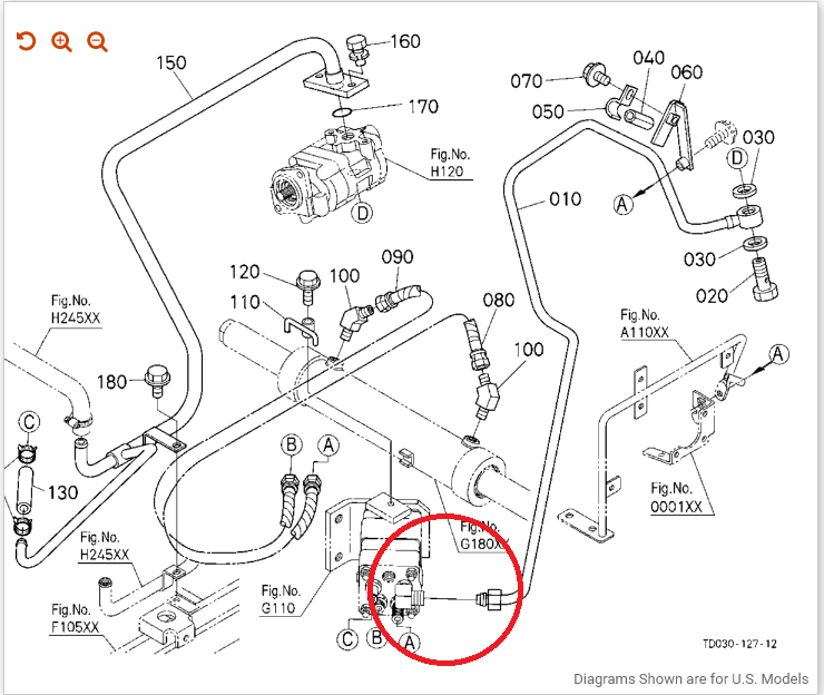

I am old fashioned when it comes to diagnosing problems
If PS is not working I would disconnect the PS supply line at the steering valve and check the pressure and flow.
