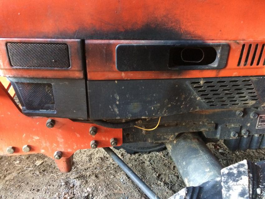

Has anyone ever made a modification to their exhaust on the L3010 or similar tractors with the exhaust that blows out the side panel? Wonder how I can keep the exhaust from blowing back in my face all the time..can't be good for you

Just looking at the residual soot from the smoke, I'm wondering if it's got an injector issue?
brokersdad
2001 Kubota L3010 w FEL
Oct 24, 2009
92
Oh? Seems to run fine, I thought it was just from years of exhuast blowing out on the panel :confused:

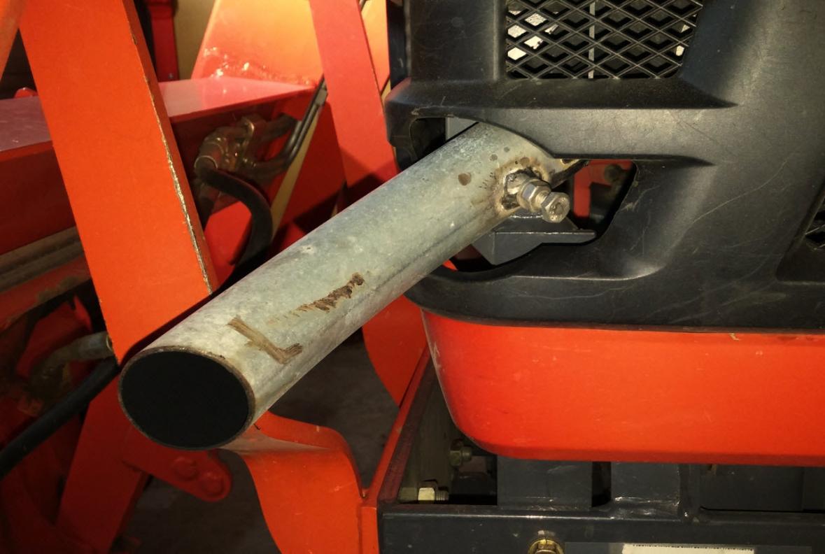

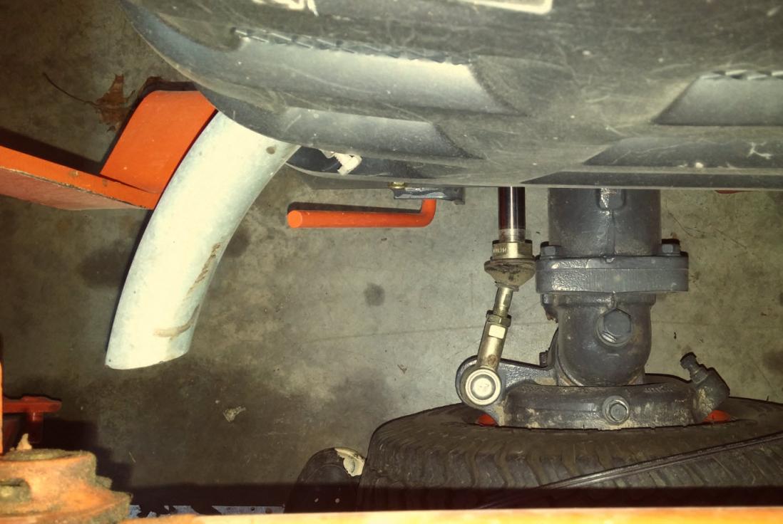

My BX2230 exhaust tended to soot up the protective grill on the front of the tractor and the FEL arms.
I used a suitable sized piece of an EMT conduit 90 degree bend that I cut down in the turn of the bend to make it the shape I wanted; it slips over the Kubota exhaust and redirects it in the direction I wanted..
Since it has to be removed to pull the side panels off the tractor, I used a bolt arrangement that holds the extension on the Kubota exhaust.. A stainless steel nut was welded to the pipe and the tip of the stainless steel bolt was ground to a taper point. The tapered bolt goes through the extension and partially into a small hole drilled into the Kubota exhaust pipe. This keeps the extension on the exhaust and keeps it indexed to the proper rotation.
The extra nut on the bolt serves as a lock nut to keep the bolt from loosening up as there is quite a bit of vibration on the exhaust.
The extension angles down and forward enough that I don't really smell the exhaust that much.
photos below....
