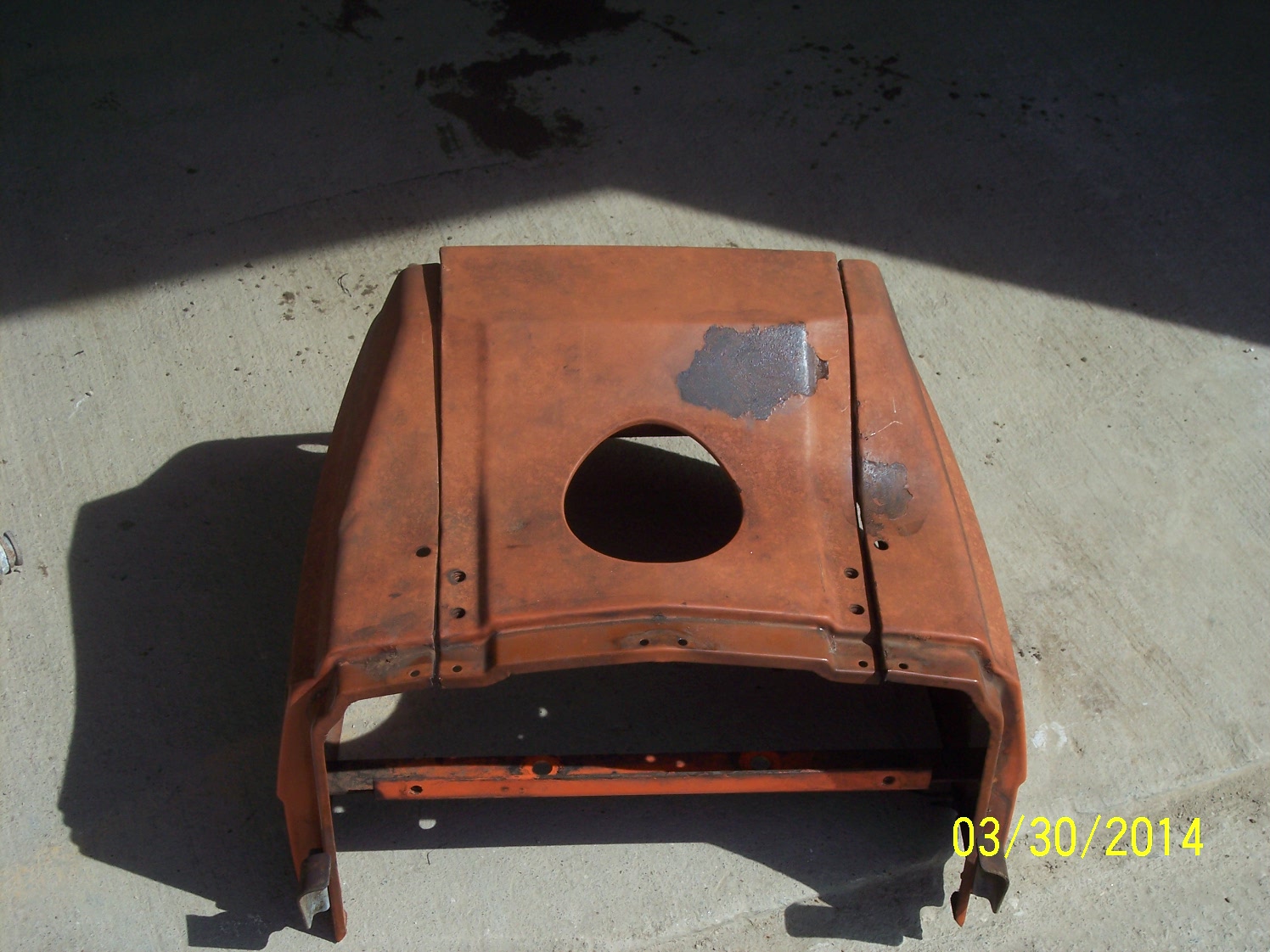

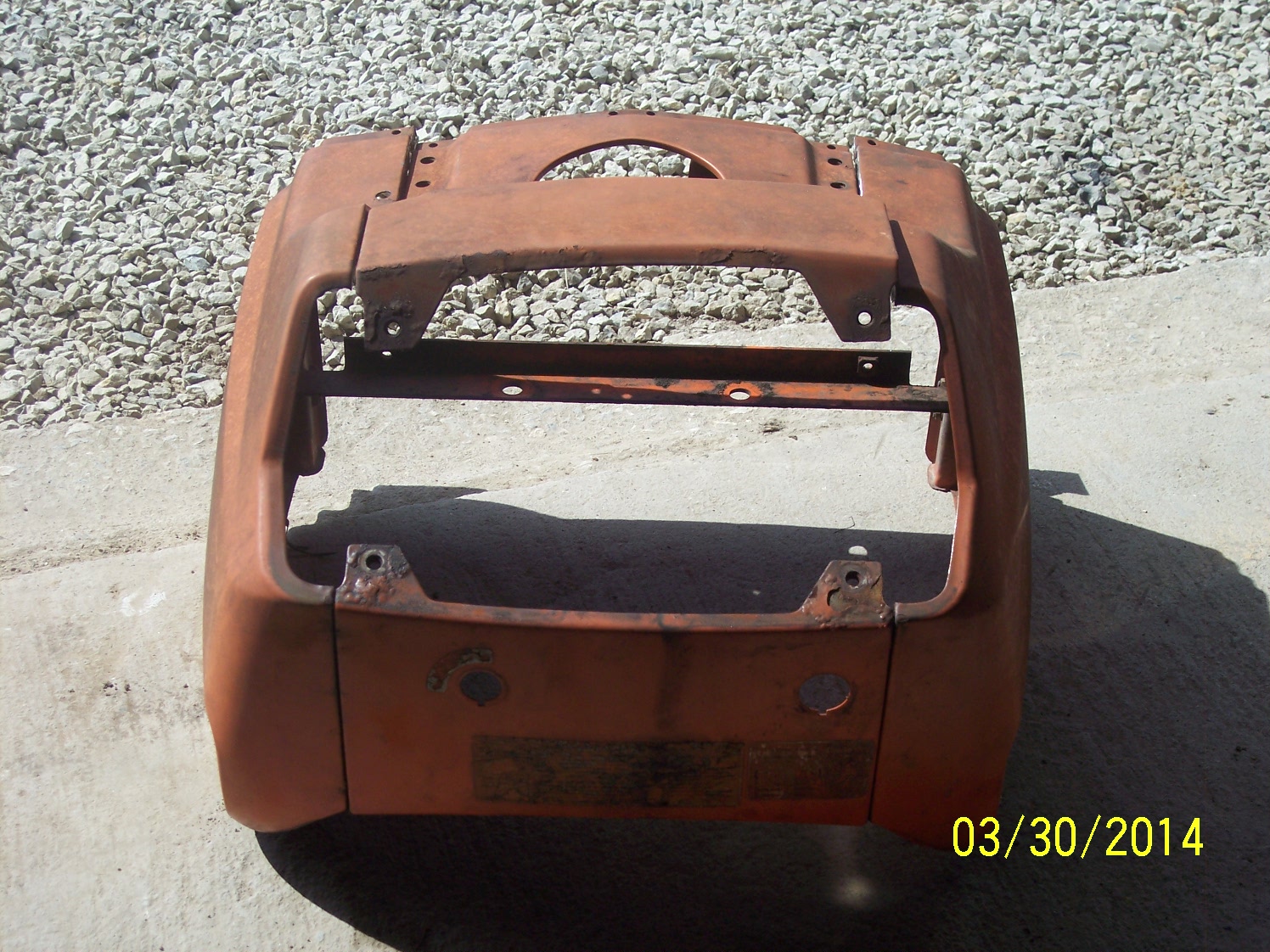

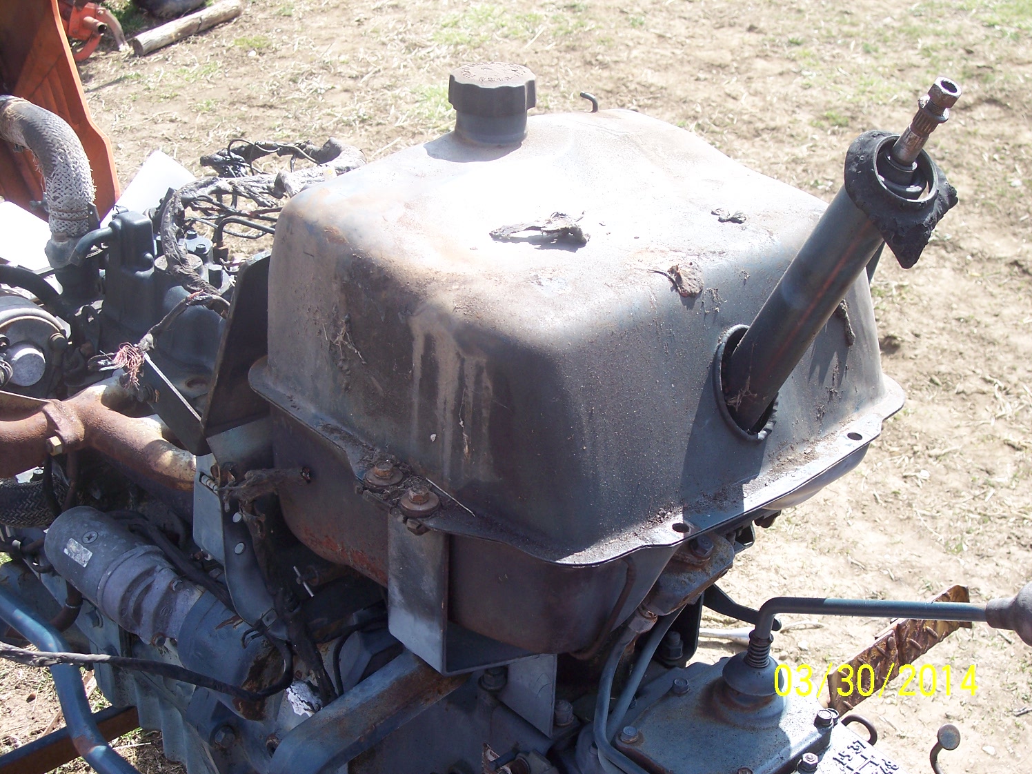

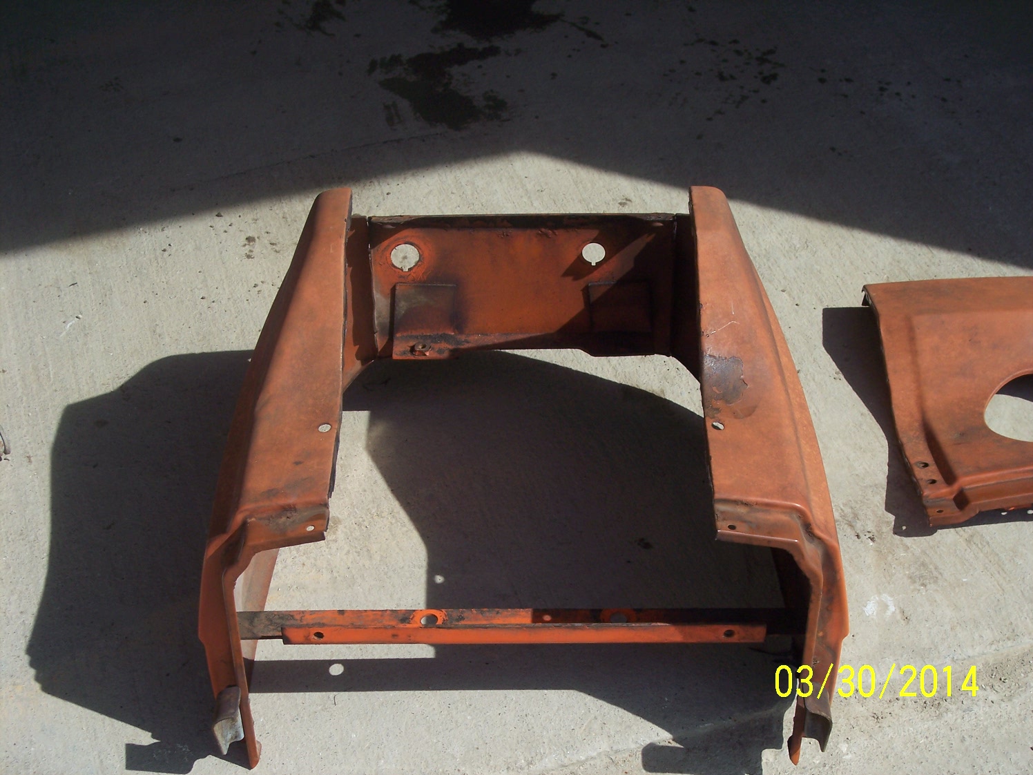

Can anyone give me help in how to get the cowl off?
I Got the steering wheel off and instrument panel, but can’t get cowl off. Where are the acres holding it on?
14,298
6,518
I can't answer your question tonight, I'll have to dig up some pictures.
I bought an L305 back a few years and that's when I came to this forum to learn the same question. This tractor had been in a barn fire and got hot enough to melt the tail light of the left fender. The wiring was toasted, the fan was melted in place. I couldn't get anything loose and wondering what I'd destroy if I started prying. I'll look at some picture and maybe I'll recall. I do know I changed it all when I finally got in there. I welded nuts to the underside of the cowling so it became bolted with SS bolts after I was done.
Here's a couple of pictures.
6,282
1,948
There are probably four total bolts (two per side) holding the cowling down. They are attaching the cowling to some vertical straps that also hold the tank in place.
In the pictures above you can see the strap in the picture showing the fuel tank.
You may have to get your eyes way down by the floor boards and then look up towards the cowling to see the bolt heads.
