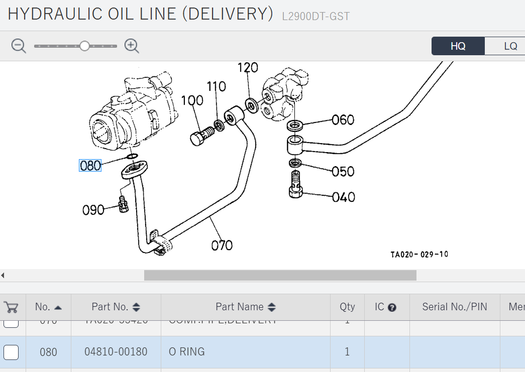

I am embarassed.... After so much advice and help here, yesterday I pulled the tractor into the garage, turned on a Salamander heater, and set to work. The work was brief.
I wrapped all the hoses to the diverter valve thing under the deck of the tractor in white foam wrap. I figured that if there was red goo on the inside of the foam, I would know which line was leaking. If there was red goo on the outside, I would know that something nearby was the problem.
Then, I tightened the two bolts holding that flange (part #90 in Wolfman's post) to the bottom of the pump. They were hand tight, but I pulled a little harder to snug them up. Being aware that the pump is aluminium, I was worried about stripping out the threads, so I stopped tightening once they felt like they were giving resistance.

So it appears that the dealership fixed the tractor, but did not torque down those 2 bolts enough to seal the o-ring. I imagine that as the tractor runs, the fluid becomes warm and thin, and was able to push around it. I am hoping that just tightening those bolts was enough of a fix to at least get me to spring.
In the spring I'll do a fluid change etc. but in the meantime, I'll just keep those bolts tight. If this backing off is chronic, then I'll try some locktite on them. If they are backing off because the aluminium is already stripped (it felt mushy when I tightened down the bolts) then I'll see about some JB Weld in there and re-tapping threads.

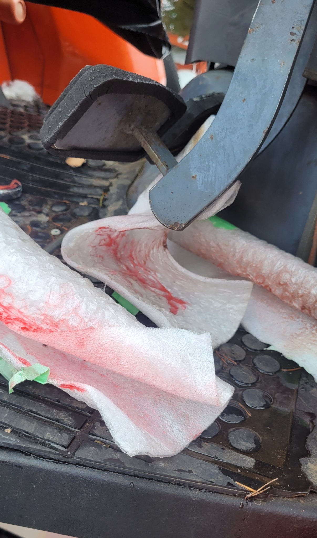

I just took the foam wrap off the hoses and all of them had some quantity of red juice. The worst hose I am having replaced, it looks cracked. The other two, I wonder if the fittings weren't crimped on tight enough, or if the quick releases are somehow not functioning properly. That all of the fittings are leaking has me suspicious of the crimps. I'm taking these hoses to a local hydraulics shop to get them re-crimped and tested.

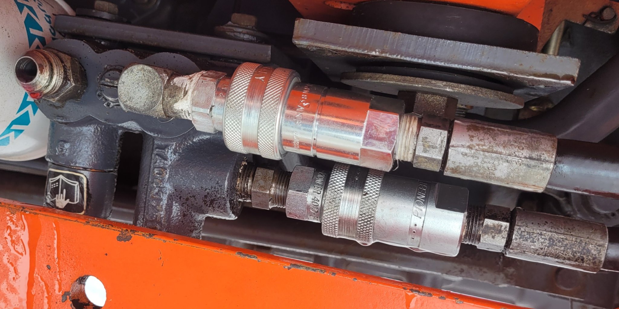

I'm familiar with helicoils (although I have never actually used them) and I have a drill press. Should be do-able at home if I can get things clamped square to the holes. Good idea, and a lot easier than my drill/tap idea.
Since you're not the original owner and therefore don't know the complete history, I'd do as someone recommended earlier and check the hydraulic pressure to make sure the relief valve pressure hasn't been over-boosted.
There are o-rings on the quick connects that have been known to leak.

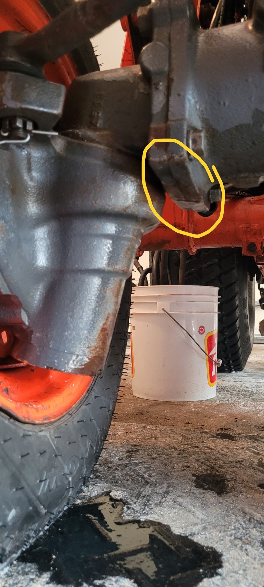

The saga continues...
Since putting on new hoses, there are no more leaks at the pump or the diversion valve (yet). Last night I pulled the tractor into the garage, and this morning there is a leak under the front right steering arm casting. It looks like the gasket holding the outer and inner sections of the casting together is leaking. Or maybe the casting wasn't put together tight enough. Or something.
I tried a wrench on the bolts holding it together and they are damn tight, so unlike the pump, this is not a matter of a bolt not being torqued enough. If there is a tightening pattern maybe it wasn't followed?
The dealership's work notes say they "Replaced Front Axle Swivel Seals" on both sides. Could this be related to that? I found this video online showing that job, and it looks like this seal is part of it. Should I jack up the tractor and take that arm off, look at the O-ring inside and reset it? Any other spots to start? Any other spots that are more likely to be the source of oil dripping from that seam?
Edit to add: The oil leaking out here is strong smelling, oil-coloured oil. Not the red transmission fluid that was leaking elsewhere.

I'm not much help with the repair, but I'm guessing the front axle has gear oil (80w-90?) in it. Has a distinctive smell and is commonly used in place of Kubota UDT fluid.
34,051
9,254
The is an O-ring seal in there.
Lift it pull the tire, drain the front axle.
Remove the bolts and cases (they will be heavy) replace O-ring, reassemble and refill with Premium UDT.

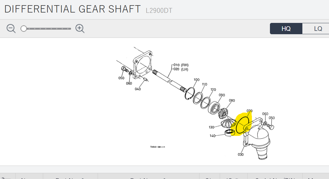

Thanks Wolfman.
What do you think the chances are of it being part 060 in this diagram? The oil is running down the casting and it could be coming from either spot. Would you just replace both the o-ring and that seal at once?
Either way, I think I'm parking the tractor out in the yard until I get parts. This will have to be a next weekend job.

Thanks Wolfman.
I'd degrease that whole area and determine where the leak is. Replacing part 060 is going to be considerably more involved than just replacing the o-ring. And the leak could be somewhere else, you don't want to dive in that oil but once.
