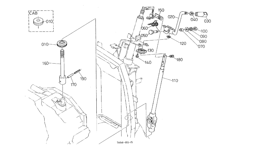

With two roll pins it isn't likely to be splined too. Probably just rusted on the shaft - did the keeper and bolt come out ok?
Riverbanks
L2900
Apr 26, 2023
15
Upstate NY
170 and 190 in the picture are the dual roll pins, they are out, still no release, also in the picture it shows the bolt still in place, that's holding the shaft in place coming out of the transmission, in the manual next picture it shows that shaft is welded to a fork in the tranny, so I think that shaft is only removable from the inside? The other possibility is the picture is separating the shafts right below the u joint, but there is no roll pins. I do see a bit of splines on the bottom of that?

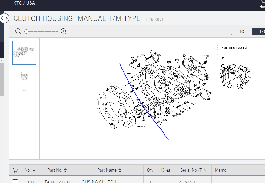

I am splitting the trans to engine seam, am I correct on that? I do see the second seam, but the access to clutch is in the forward seam
33,384
8,699
You're splitting it here right?

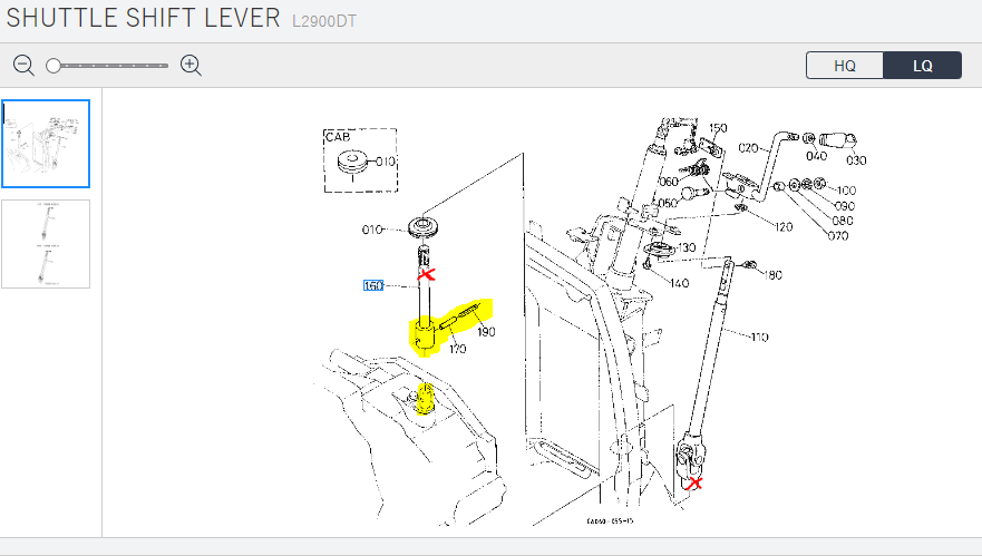

There are 2 ways to separate the shuttle shaft, lower in yellow is not splined smooth shaft.
connections in red are splined, put a alinement mark on the shaft and the joint if you are separating it here.
If you lift the column and use a hammer to tap up on the joint one of the connections will come loose.

Update, had friend(owner) come over, with no progress on separation, we cut the lower shaft with a sawzall, he found a used part for 20$, it will be a lot easier to remove the lower piece with the tractor separated, bash me if you want, I felt like a hack doing so, lol, thanks again to all, I'll stick around. I have a t1400 rider from 92', and a 6500av generator from 03', probably will ask for assistance at some time
33,384
8,699
Sometimes we just gotta do what we gotta do!
Save the parts so you can match up the clocking of the shaft or it won't shuttle.
