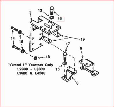

North Idaho Wolfman Moderator Staff member Lifetime Member Equipment L3450DT-GST, Woods FEL, B7100 HSD, FEL, 60" SB, 743 Bobcat with V2203, and more Jun 9, 2013 28,872 5,230 113 Sandpoint, ID Dec 7, 2014 #2 Does not appear that there is a sub frame, looks strictly 3 point mount. There is a reinforcing top bracket you can get for the top of the 3 point. Attachments L2900 Three point bracket.JPG 30.4 KB Views: 1,563 Last edited: Dec 7, 2014
