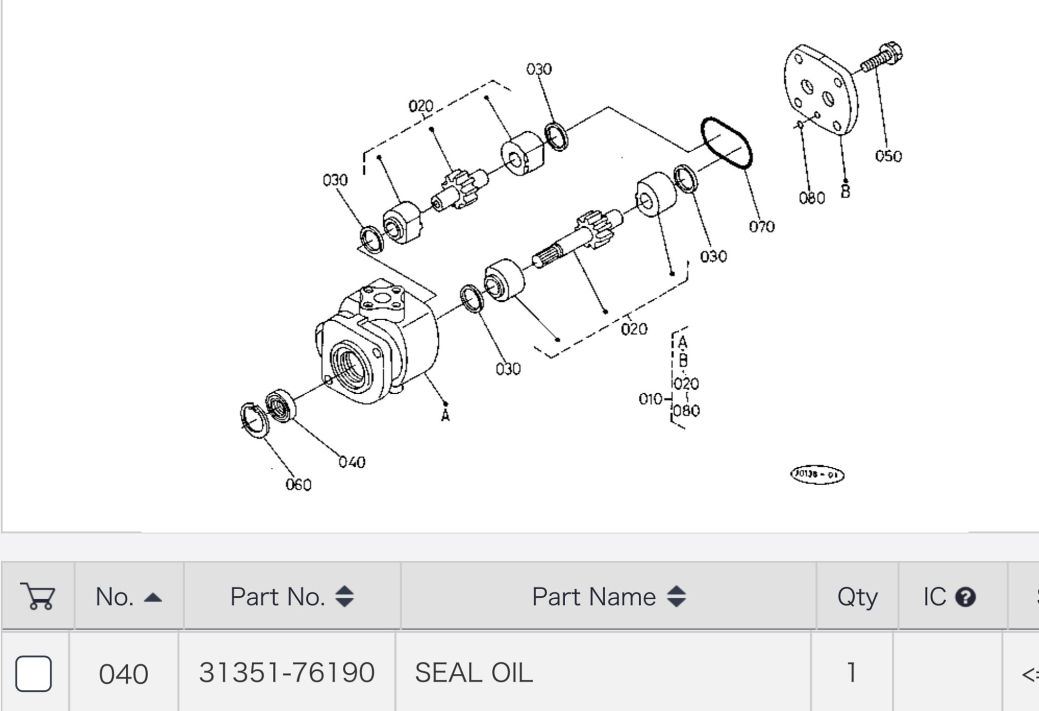

5,949
1,741
Hi there,
Also have a l2850 with hyd oil in the engine.
Anyone got pics or basic info of whats required, asking as I dont have the machine with me currently but would like to get parts organised and prep for the operation ahead.
Thanks in advance
There are illustrated parts lists at this site
There are several models and serial numbers that can change the required part numbers. There is also a pump for manual steering and another for power steering. This is an example of the manual steering pump illustrated parts list
